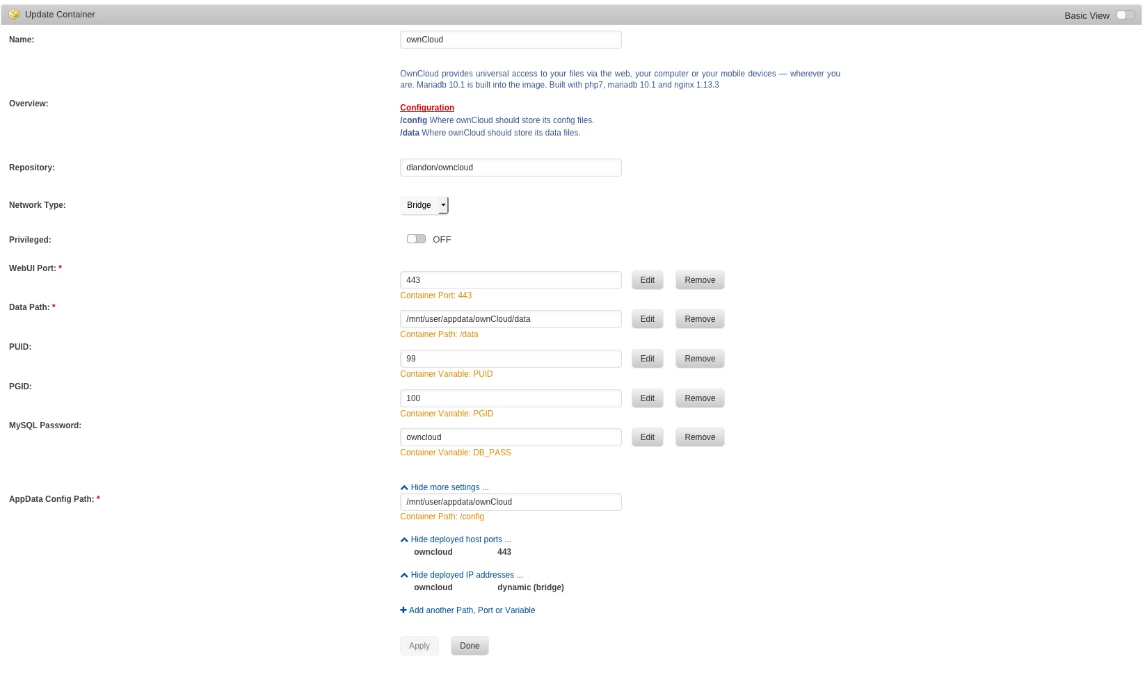

Kindly I would like to ask how I could resolve the issue that owncloud would not start. However the software seems to start when I change the webUI port to 446 (
  443/tcp 192.168.20.62:446)
however the when accessing that adresss there is an error on on my webbrowser (FireFox). Changing it back to 443 results into this error message:
under command:
root@localhost:# /usr/local/emhttp/plugins/dynamix.docker.manager/scripts/docker run -d --name="ownCloud" --net="bridge" -e TZ="Europe/Berlin" -e HOST_OS="unRAID" -e "PUID"="99" -e "PGID"="100" -e "DB_PASS"="owncloud" -p 443:443/tcp -v "/mnt/user/appdata/ownCloud/data":"/data":rw -v "/mnt/user/appdata/ownCloud":"/config":rw --log-opt max-size=50m --log-opt max-file=1 dlandon/owncloud
81375e6734de7d919ecb986e91384e84d1012bddf2732f7131fcc51e3fd5eee5
/usr/bin/docker: Error response from daemon: driver failed programming external connectivity on endpoint ownCloud (bd07e2583cea0ccd9813189df4bab59aa2f5b5efe3be314d57f92b2abd05e5c1): Error starting userland proxy: listen tcp 0.0.0.0:443: bind: address already in use.
The command failed.
Any suggestions how to resolve this issue??

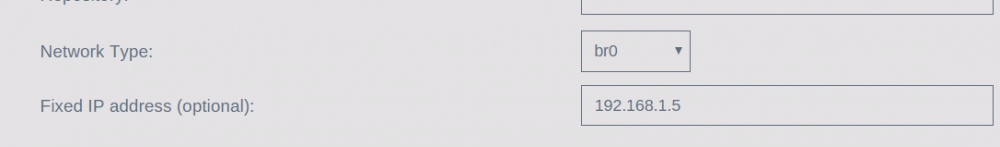

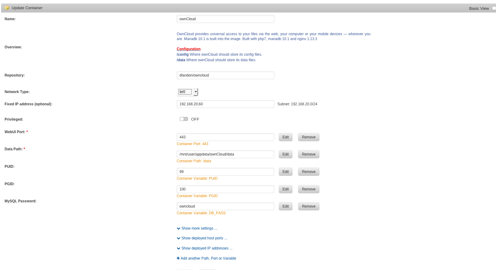

Set the network type to br0 and give the docker its own IP address.  The 443 port is used by unRAID.
Thank you very much for your very quick reply
Eventhough I have done that and software seems to have started (green arrow)... I am not getting access to the webUI on that adress (http or https). Are there any other settings I should check?
Click on the docker icon and select webgui.
Edited by dlandon
My bad. I forgot that I needed to make an exeption for the SSL certificate as it is selfsigned.... It seems all work not properly. Next item on the list is to install a propper SSL certificate.
Thank you very much for your time dlandon!
