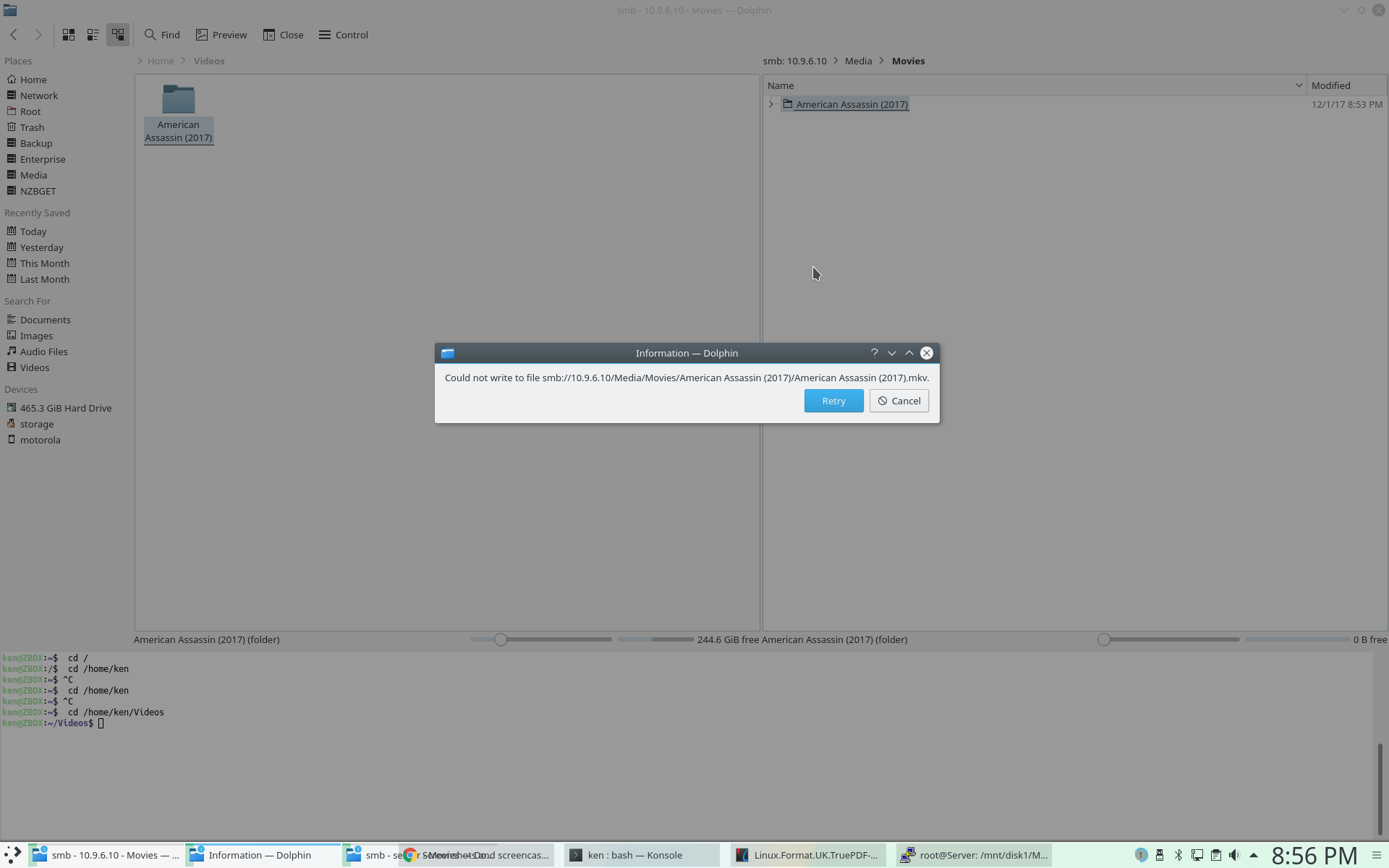

Hi i am having some issues moving files from my pc (which is running linux )
 to my unraid system the file starts moving and then just tells me that it can move the  file.i fill like i have my settings right. not sure why the  file want move.any help would be appreciated.thanks
Post up your diagnostics file  (   Tools     >>>  Diagnostics   ) with your next post.
You could also have a look at your syslog on your linux computer.
Do you have another device/computer that you could try to see if you can upload from it?
Syslog looks normal, does a copy instead of move work? Do you have a PC running another OS you could try, like Windows?

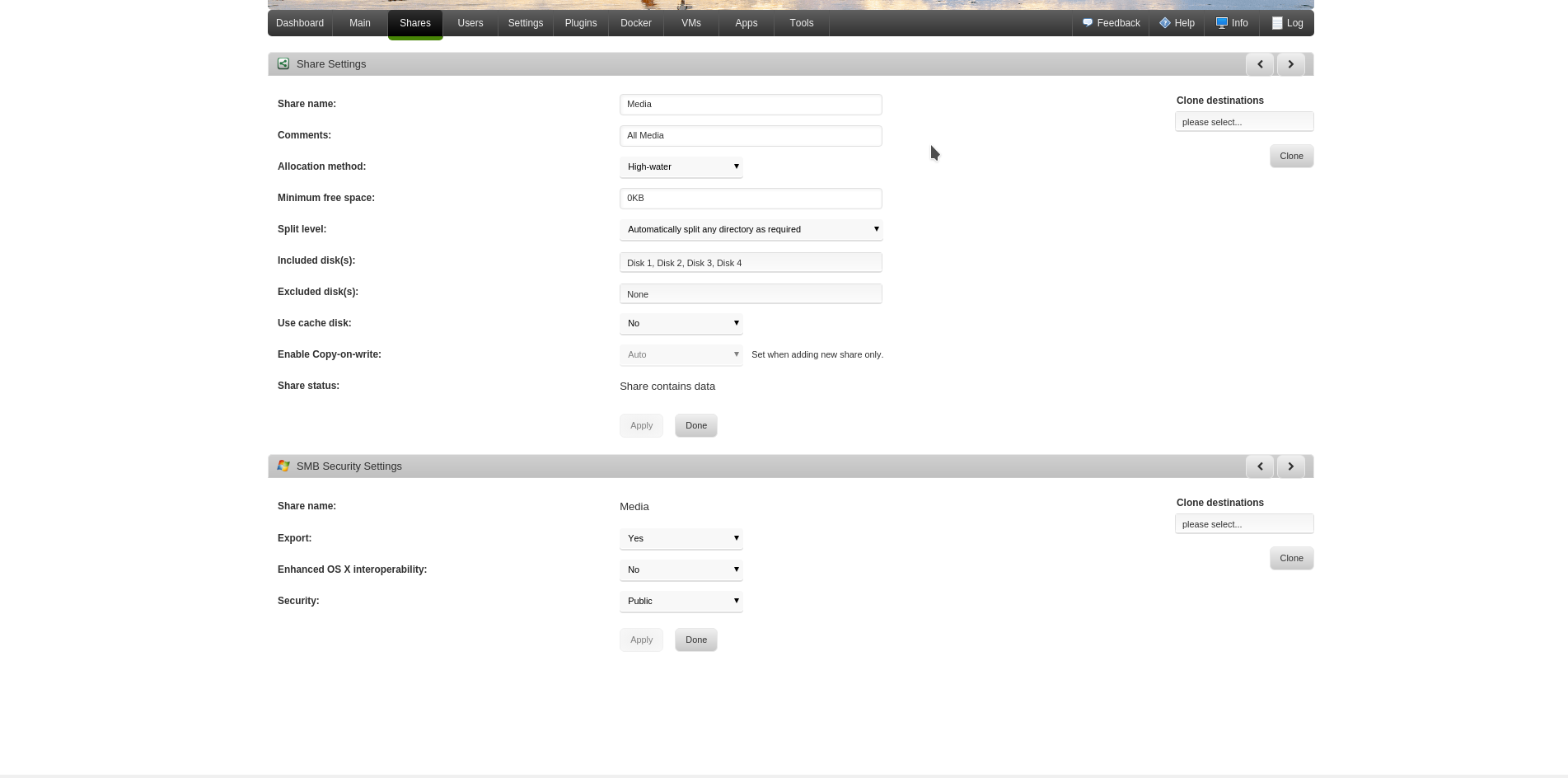

were should my appdata, domains, iso, and system folders be located right now they are on disk1  i thought they should be on my cache disk thanks for fast reply
They are cache "prefer" by default, if you shutdown docker and VM services and run the mover they will me moved to cache.

ok it left a copy of system folder and left the isos folder
If they're empty you can delete them.
what about the iso should it be on the cache or on one of the other disk
As you like, it's currently set to cache "yes", probably the default, if you want it on cache change that share to cache "prefer" and run the mover.

a quick update i was able to move over the file from a windows pc do you know of any reason this is happening
No, but it confirms it's not an unRAID problem.
yes i will dig into that problem. i did move the file to a different server not unraid though .
