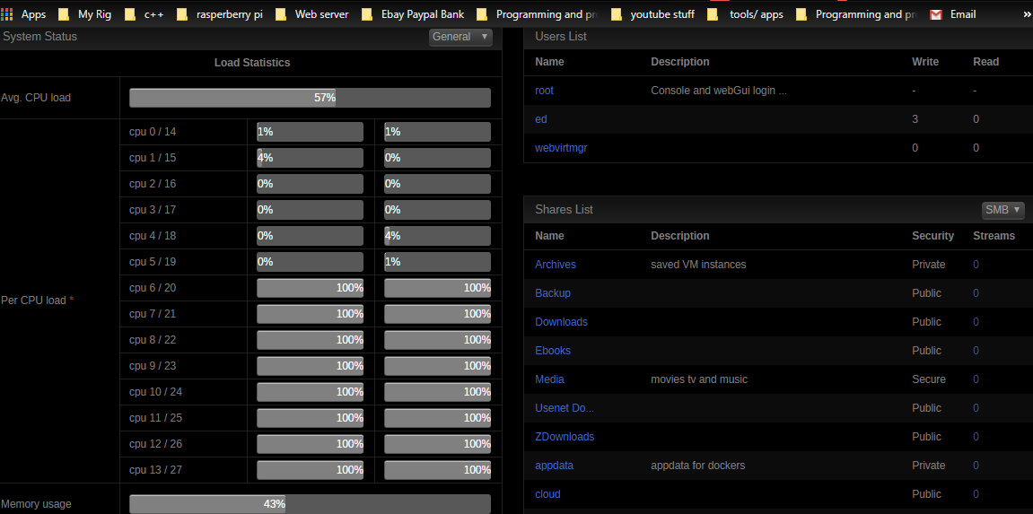

I have noticed that behaviour with one of my servers. If I assign a large number of cores in windows VM eg 8 cores plus
then the CPUs hit 100% on the start of the VM. Nothing happens for about 1 minute 30 seconds then the VM loads, CPU goes back to normal
and VM is fine.
Try waiting and waiting and waiting and see if VM starts up. Also, try fewer cores and see if that speeds up the boot.
I find it happens to me if I use GPU 1, GPU 2  VNC graphics, so the Vbios passthrough isn't what effects this behaviour for me.
I also use an ASRock x99 board, so maybe it is in to do with our boards as I haven't heard many people with this issue but those who have normally have large amounts of ram of CPU cores assigned to the VM.
