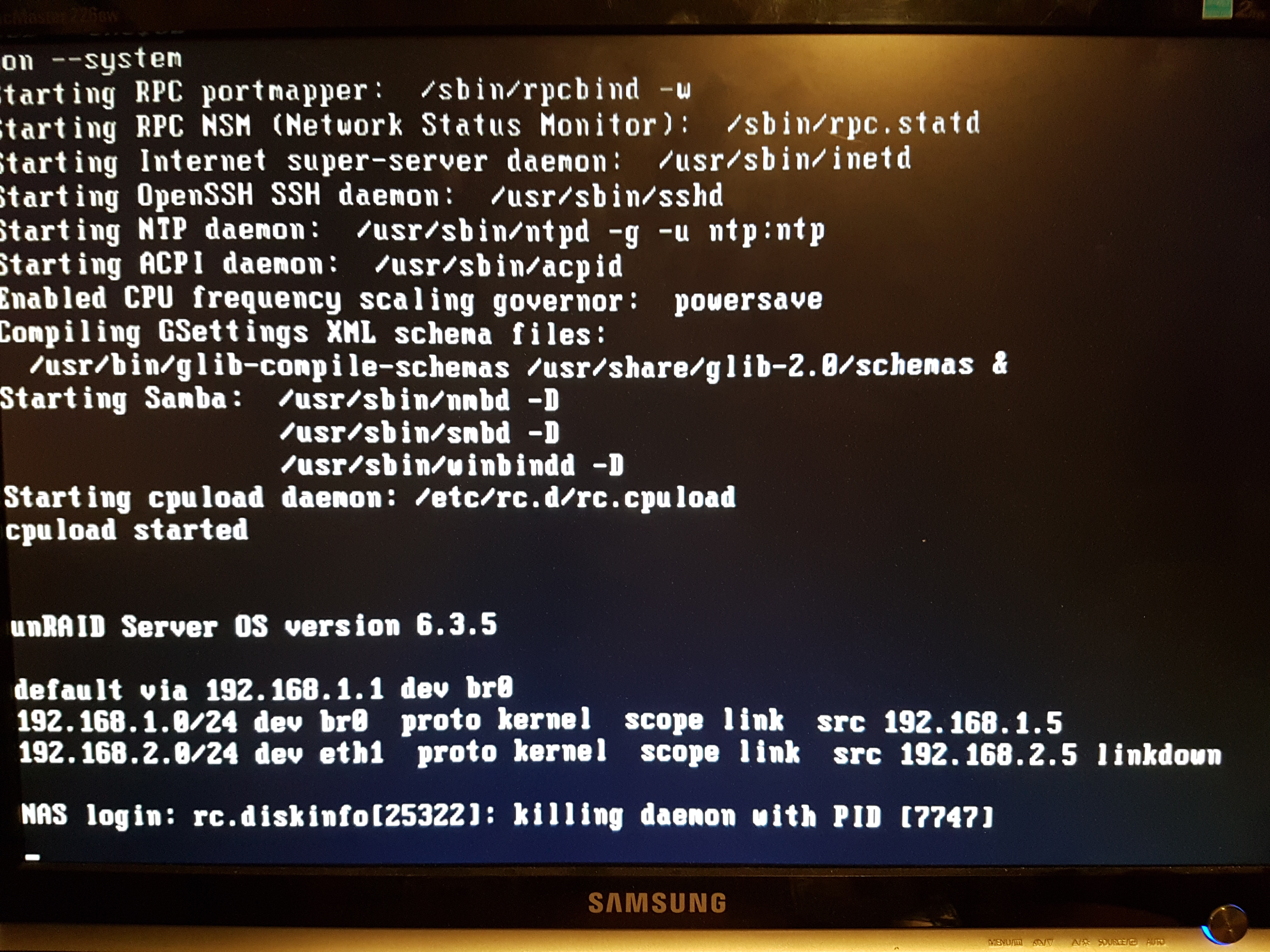

Attached is a screenshot that I took from the unRAID monitor and the logs. Anyone an idea what happened there?

The screenshot I provided in the first post does not help to track down the cause of my unRAID freeze though. Or?
No, the screenshot is from the boot - a screenshot before the reboot might possibly have contained any critical errors.

The screenshot was taken when unRAID was in the frozen state. It was *not* taken after the forced reboot.
OK. Then it never emitted any critical error when it locked up.
The only line it emitted after it had started up was the last part of the last line. After the login prompt, it emitted that it had stopped PID 7747. But that isn't an error message.
But it's fully possible for a machine to freeze without emitting error messages too - it's just a question if some part of the Linux code has time to spot any error or not.

Yeah it responded to a ping, but neither the webGUI nor SMB worked.
The console did not respond to the keyboard either.
