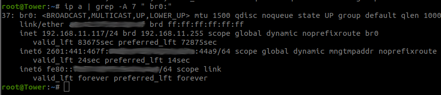

I have an issue that docker doesn't have IPv6, this is one of my containers
# docker inspect 433692b3e691 | grep -i IPv6Gateway
            "IPv6Gateway": "",
                    "IPv6Gateway": "",
Looking at my docker networks, I see:
# docker network ls
NETWORK ID          NAME                DRIVER              SCOPE
224d0c66e092        bridge              bridge              local
bb9929d48bc0        host                host                local
19eea3a1aa0b        none                null                local
THE BRIDGE
# docker inspect  224d0c66e092 | grep -i IPv6
        "EnableIPv6": false,
                "IPv6Address": ""
                "IPv6Address": ""
                "IPv6Address": ""
                "IPv6Address": ""
THE HOST
# docker inspect bb9929d48bc0 | grep -i IPv6
                "IPv6Address": ""
                "IPv6Address": ""
                "IPv6Address": ""

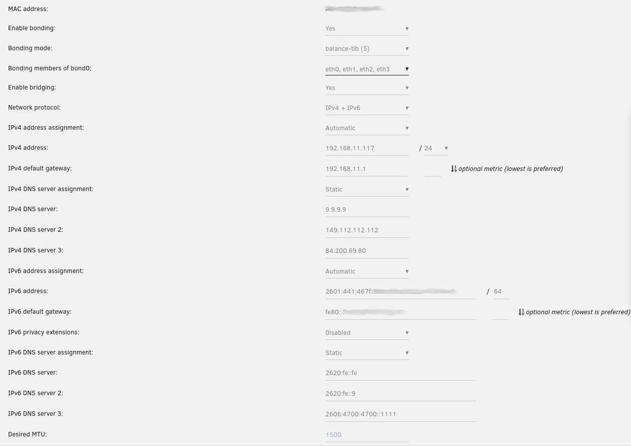

However on the GUI and the command line, the bridge is enabled and has IPv4+IPv6 and the tower itself has an IPv6 address
Any help enabling docker to have IPv6 instead of "EnableIPv6": false will be appreciated
