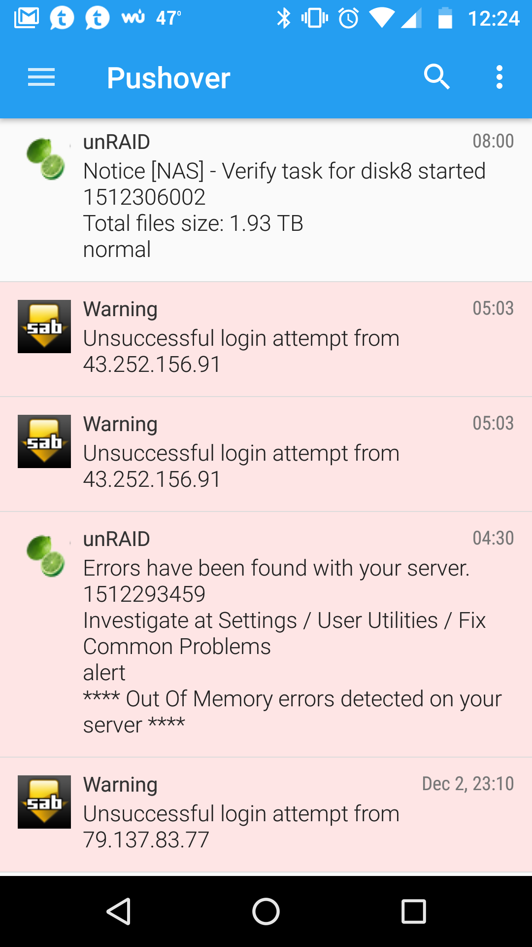

Woke up this morning to an Out of Memory warning from FCP. Posting diagnostics. In the last 24 hours, I've added jbrodriguez's ControlR plugin & LinusServer-IO's OpenVPN-AR docker, so I may have been running on the edge previously and they pushed me over.
Also, SAB has reported several failed login attempts from outside IP addresses. Not sure if they'd have anything to do with it, but I thought I'd mention it as a possible factor. If they seem to be totally unrelated, I'll post that in the SAB docker support thread for recommendations on what to do there. I am going to change the SAB port & password, just to be on the safe side.
I'm up for any and all suggestions.
TIA!
nas-diagnostics-20171203-1223.zip
