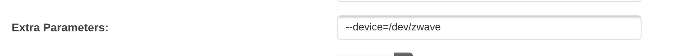

USB devices connected to the server need to be mapped.
Also be sure to give your USB a permanent name so that in the event of a server reset, then device name is not tagged with a different number rendering the device mapping invalid.
Below is how my device is mapped in my Home Assistant docker:
Hi again,
Who do you mapp a usb device and get a static name on it?
I got lots of errors when I add the parameters: /dev/ttyACM0 and also use this link in the applications.
