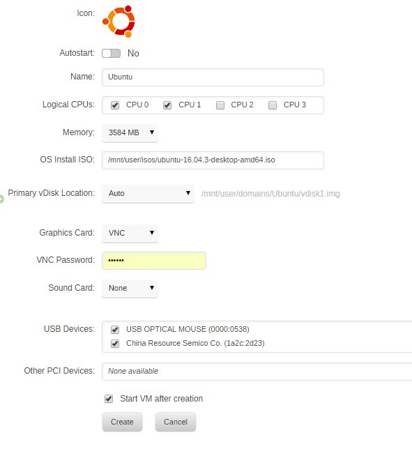

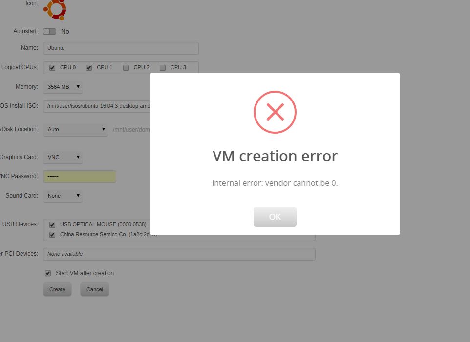

Tried to create VM with Ubuntu and ended up with this error. Am not sure what's to blame here ? Anything please.

2017-12-04 18:37:27.305+0000: 7020: info : libvirt version: 2.4.0
2017-12-04 18:37:27.305+0000: 7020: info : hostname: Tower
2017-12-04 18:37:27.305+0000: 7020: error : virDomainHostdevSubsysUSBDefParseXML:5722 : internal error: vendor cannot be 0.
2017-12-04 18:40:39.819+0000: 7021: error : virDomainHostdevSubsysUSBDefParseXML:5722 : internal error: vendor cannot be 0.
2017-12-04 18:40:46.445+0000: 7019: error : virDomainHostdevSubsysUSBDefParseXML:5722 : internal error: vendor cannot be 0.

I was asking for the full diagnostics file, but as a quick test, can you try starting the VM with no USB devices assigned?
I think the issue is the USB mouse you are trying to assign.  It has a vendor ID that starts with four zeros and libvirt apparently doesn't like that very much.  Please try using a different USB mouse and see if that works for you.

Woow great pal. Its working without the mouse and Keyboard attached :D Fantastic But is it the problem with this particular mouse or any mouse might bring me here ?
It is a brand new cheap intex mouse. I think its made in india? I dono. But that has made a pass after leaving the keyboard and mouse unchecked.
Hi again,
In the future, when we ask for diagnostics, it is best to just attach the entire zip file.  I think your mouse is the issue.  If you can try a different one I bet it would work just fine (different make / model).
