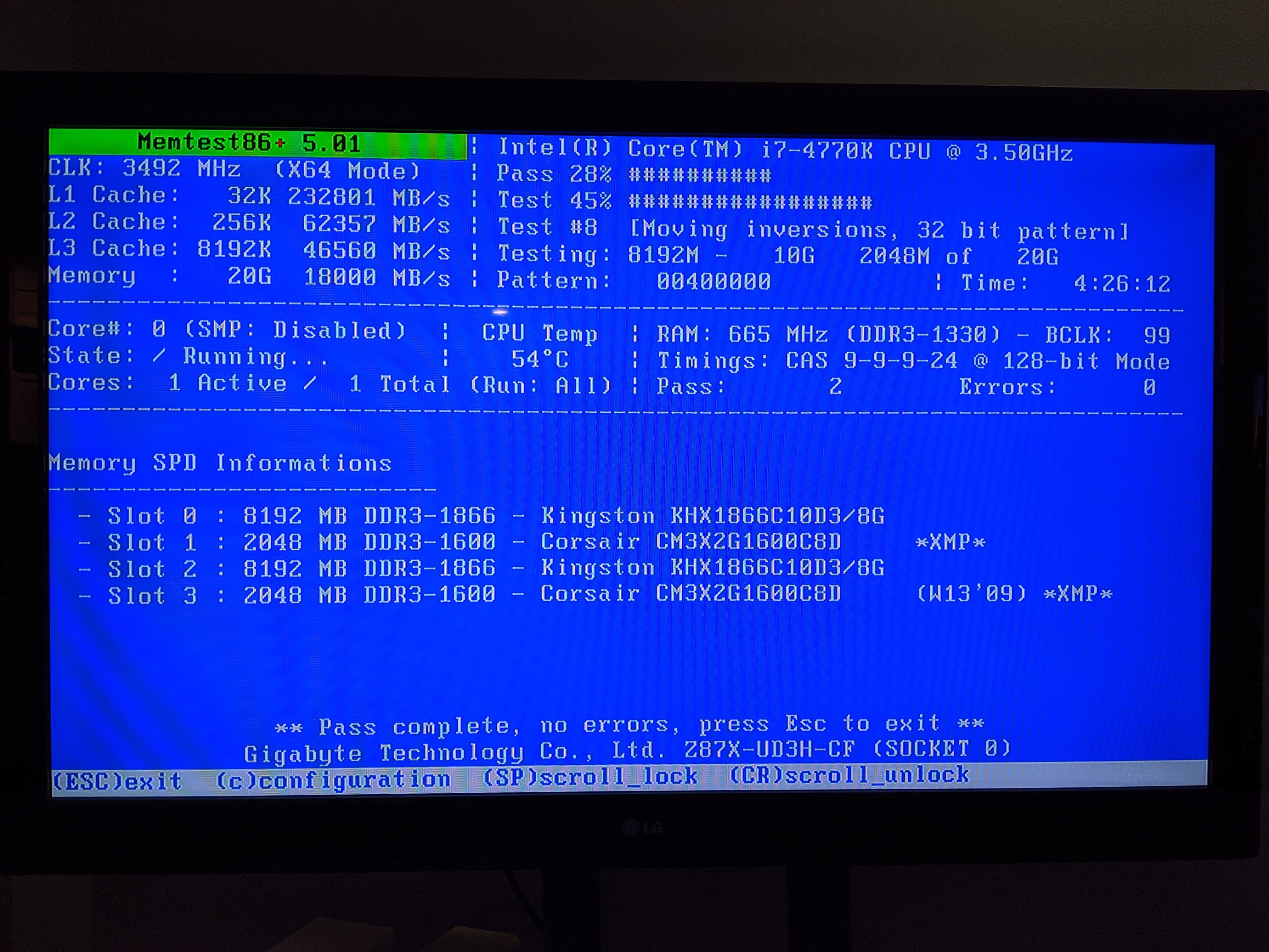

Have you done a memtest?
hey thanks fer getting back to me
I did read your previous post and have since switched it to Cache Yes.
A memtest was done, yes, and it passed. I thought of that myself earlier today and did that when it froze on me this morning.
Does anything else pop out at you?

I will be out of the house for a while today so I've decided to run the extended memtest, and assuming that passes everything, I will boot the server when I get home into safe mode and attempt to rebuild the parity again (5th time)

memtest has been running for 4.5 hours and no errors
