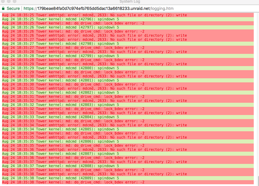

having the same problem now. i got home and my shares are no longer showing on unraid.
my dockers and VM have disappear, if i try to reboot or power down, it doesnt work, i have to hard reboot.
below is my diagnostics, also a screen shot of the log error i'm getting
tower-diagnostics-20180824-0730.zip
Your cache drive dropped offline.  Most likely a poor connection on the sata/power connectors.  Reseat.
Additionally, disable mover logging (settings, scheduler, mover settings) - serves no real point, but just takes up log space.

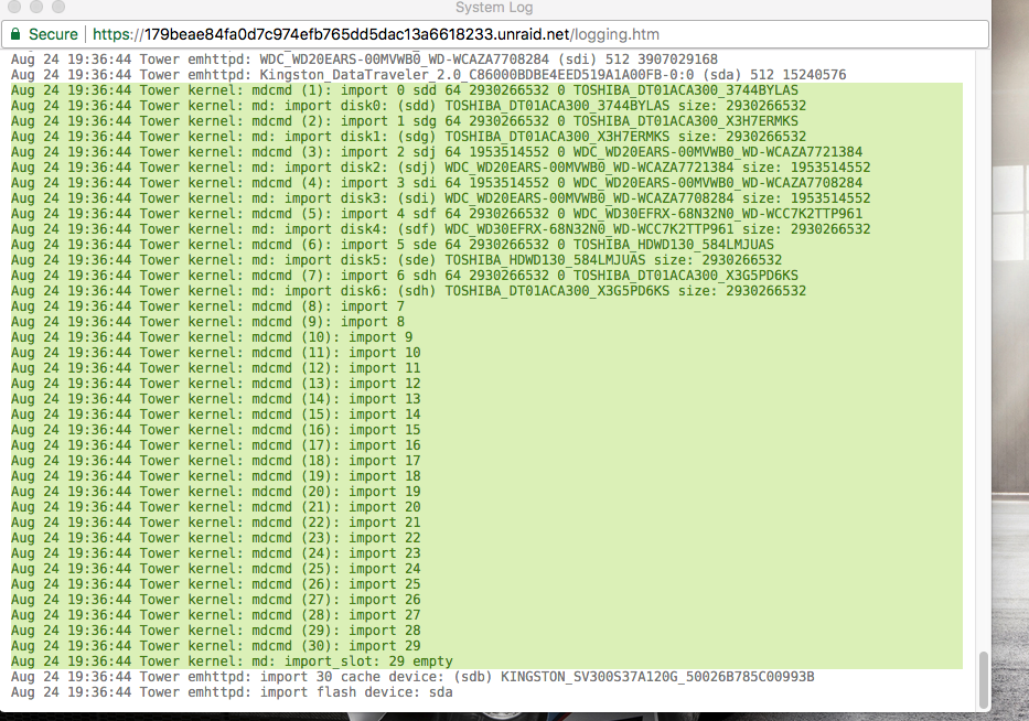

thank you Squid.
i was able to check all the wires, and harness to power supply was off.
all came back ok, however, i now have a brand new disk i install two weeks ago showing me a red x. smart test is showing in good shape.
i'm not sure why is not given me a green light.
here's the log and diagnostics, and also a screen shot of the system log
tower-diagnostics-20180824-1934.zip
hi everyone i followed these steps thank you all for the support. i will check back once the parity finishes rebuilding.
Disks get disabled only if a write to it failed.
I would guess that the odds are decent that in the process of fixing the power to the cache drive, you slightly knocked out of place the sata / power connector to your other drive (why I'm a huge fan of hot-swap cases - even the cheap ones are worth their weight in gold).
