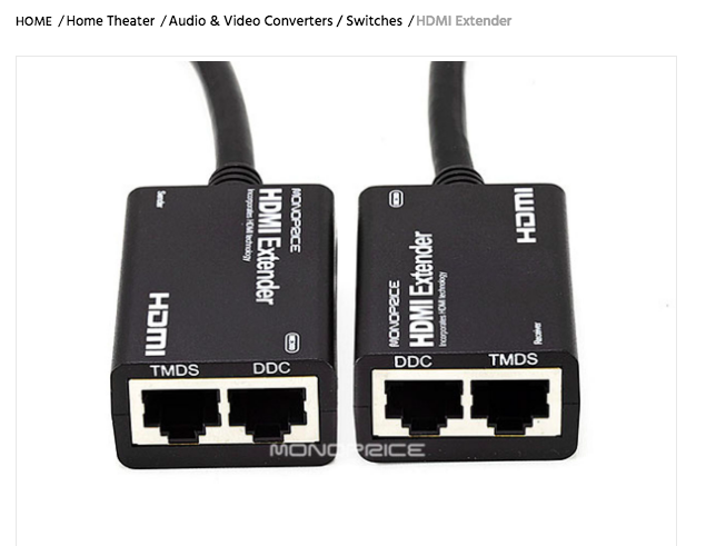

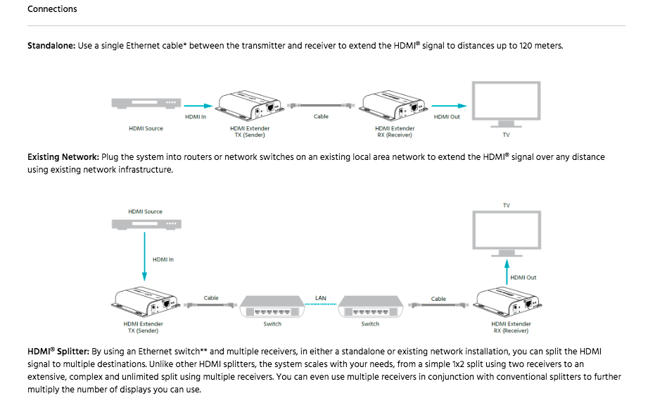

Last question, anything with both hdmi and USB combined? So I use lesser cat5e.  These devices cannot be passed through switches?  Or can they?  Meaning, in between devices, should be straight cat 5e?  Or can they be plugged to switches?  I'm attaching a diagram I saw on monoprice.  This will solve my lacking of cat 5e runs between my room and my nas.
Is the case above applicable also for something such as this?5a2882970f2b9_ScreenShot2017-12-07at07_50_48.png.e35c12cf443b0723b4d4c70d5dab86b4.png

the solutions above aim to do the same as what you need.  I think that the HDMI over RJ45 is good for very long distances (100m) if you are working in the range of 15m you dont need it.
and you need cat6 not cat5e.  forget about the cat5e for the remaining of your life :)  . its not a life and death issue, for upto 5m its not .
but if you have a better technology. why not use it , ha?
hdmi and USB combined?  if you have the money. the solutions are there, just cost by a multiple factors higher.
in the end you have one HDMI extension cable and one cat6 cable running to the monitor.

There are products which include both hdmi and usb passthrough such as the following:
https://www.newegg.com/Product/Product.aspx?Item=1DJ-009H-00001
I have no actual experience with said product, but they do exist and they're fairly inexpensive. No, they're not as cheap as beer, but you generally get what you pay for and around $100 isnt bad at all for the convenience it provides.

I was wondering though if using the powered device I link above, since it's only using 1 cat5 or 6, will be less functional than the passive device using 2 cat5 or 6 cables?  Is audio lost, or what else am I sacrificing for using a single ethernet port?  I prefer it since I have limited cable runs from the other room to my room.
