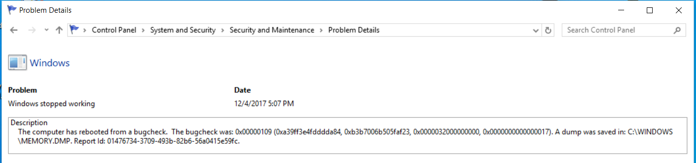

My Windows 7 Pro vm just hung on a restart. Force stop returns with Execution error. Failed to terminate process 32574 with SIGKILL: Device or resource busy.
Previously the same had happened to my Windows 10 vm as well but I put that down to just being Windows.
Shutting down via the GUI that time resulted in unRaid seeing an unclean shutdown with the expected parity check on reboot.
No manual edits to either xml file.
Latest bios is installed.
ps ax give this for the process.
32574 ?        Zl    13:11 [qemu-system-x86] <defunct>
32581 ?        S      0:00 [vhost-32574]
32586 ?        S      0:00 [kvm-pit/32574]
Attached diagnostics are before I try to reboot again.

It looks like this is the error that Windows 10 says caused the VM to shutdown/hang:

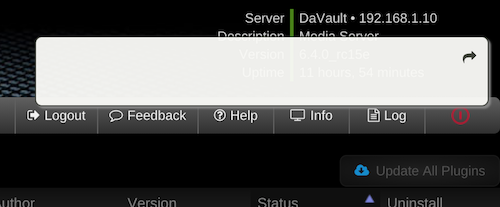

Also noticed blank pop ups during docker or plug-in upgrades.  Until the docker or plug-in page is manually refreshed, the blank message doesn't go away nor does it update when the upgrade process is finished.
This is the "Advanced Buttons" plugin you've got installed doing this.  Nothing to do with 6.4 itself.  Alternatives is to setup CA AutoUpdate, or uninstall Advanced Buttons and do each update manually.
Edited by Squid
CA AutoUpdate is enabled, so I uninstalled Advanced Buttons.
