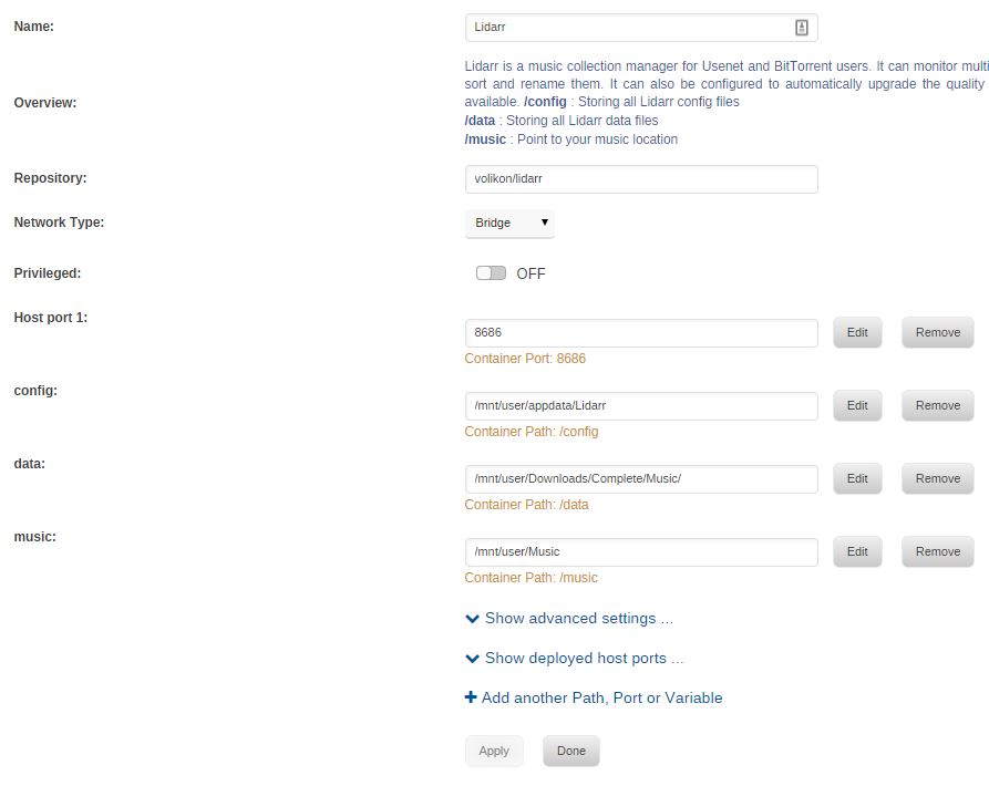

December 6, 20178 yr all working so far except I can't assign an IP to the docker - I need this for it be to be able to talk to my other dockers e.g. nzbget. Works on bridge What's the data folder for? is this supposed to be the download folder?

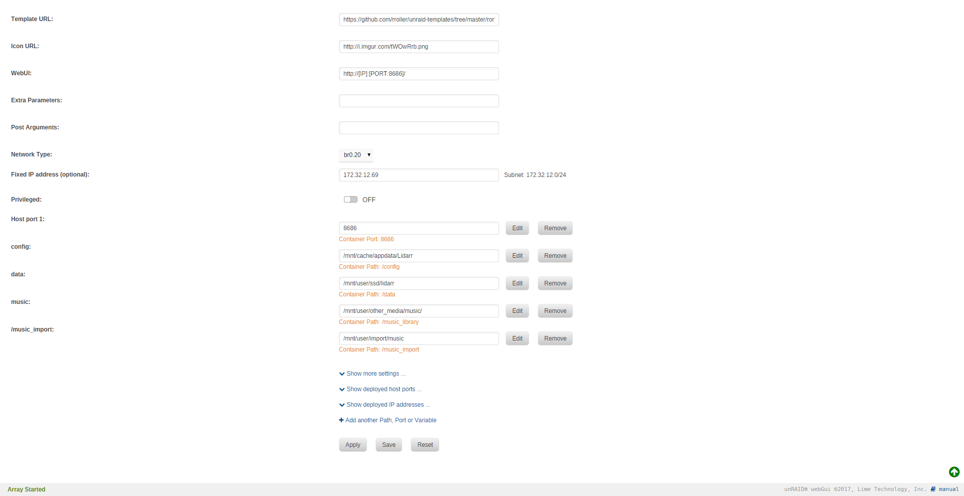

December 13, 20178 yr Unsure of the pathings. I suppose the part that throws me a bit is the separate /config and /data ("data" being somewhat new and different from the other dockers I've used) And paths for where to download, for example for Sonarr and Radarr it is /mnt/cache/appdata/downloads (then I have Sab categories setup so there are /tv /movies /music) as well as the path of where the processed media should go (i.e. the share) whereas for Radarr and Sonarr they are /mnt/user/movies and /mnt/user/tv respectively. I tried /mnt/cache/appdata/lidarr for /config and /mnt/cache/appdata/lidarr/data for /data with no dice (it claims it cannot access configuration data).
December 14, 20178 yr Here's what I did to get it running: Pointed /config to a lidarr folder in appdata like you do with every other docker. Pointed /music to the folder where the music is stored. /data does not seem to do anything but I pointed it to the same folder as /config Added the container path /downloads and pointed it to the downloads folder. Added the variable PUID and set it to 99. Added the variable PGID and set it to 100. I recommend joining the lidarr discord for support.
December 16, 20178 yr /data would be the downloads folder. Edit: or it should be if the template matches the ones for sonarr and radarr. Edited December 16, 20178 yr by lordbob75
December 16, 20178 yr The template is incorrect. If you check the docker file it's /downloads https://hub.docker.com/r/volikon/lidarr/~/dockerfile/ # ports and volumes EXPOSE 8686 VOLUME /config /downloads /music

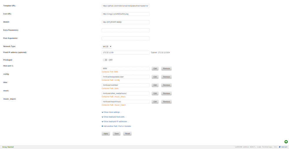

July 26, 20188 yr 1 hour ago, JohanSF said: Hey DZMM, I want to do this myself. Is it possible that you can share a screenshot of the "custom script"-connection you have set up in Lidarr and your beets config? That would be of utmost help now that I am getting started with this myself. I've seen scripts for triggering a beets import from lidarr, but I don't use one. I do an input manually whenever Im in the mood to use beets directory: /highlander/other_media/music/adults library: /config/musiclibrary.blb art_filename: albumart threaded: yes original_date: no per_disc_numbering: no import: write: yes move: yes resume: yes incremental: no from_scratch: yes quiet_fallback: skip none_rec_action: ask timid: no log: /config/beet.log autotag: yes duplicate_action: ask ########### DOCKER DEFUALTS ################# paths: default: $albumartist/$album%aunique{}/$track - $title singleton: Non-Album/$artist - $title comp: Compilations/$album%aunique{}/$track - $title albumtype_soundtrack: Soundtracks/$album/$track $title replace: '^\.': _ '[\x00-\x1f]': _ '[<>:"\?\*\|]': _ '[\xE8-\xEB]': e '[\xEC-\xEF]': i '[\xE2-\xE6]': a '[\xF2-\xF6]': o '[\xF8]': o '\.$': _ '\s+$': '' web: host: 0.0.0.0 port: 8337 ########### My additions ##################### # import folders are deleted if only files matching these patterns are left in folders clutter: ["Thumbs.DB", ".DS_Store", "*.m3u", ".pls", "*.jpg", "*.png", "*.lrc", "*.cue", "*.opf", "*.sfv", "*.txt"] ########### PLUGINS ##################### # chroma and web installed with docker # # removed lyrics from plugins below plugins: fetchart lastgenre embedart ftintitle convert scrub replaygain missing chroma web duplicates missing fromfilename fetchart: auto: yes cautious: yes sources: filesystem coverart amazon albumart google fanarttv wikipedia google_key: AIzaSyCyfcvvrxLovyjWzqgjt0kS0r6B0vJI9-E fanarttv_key: a013aa2ee126dfbe268c1a51fff7b2a7 # lyrics: # fallback: '' # force: yes lastgenre: auto: yes source: track canonical: yes canoncical: /config/genres-tree.yaml fallback: unknown whitelist: /config/genres.txt embedart: auto: yes ftintitle: auto: yes convert: auto: no ffmpeg: /usr/bin/ffmpeg opts: -ab 320k -ac 2 -ar 48000 max_bitrate: 320 threads: 1 scrub: auto: yes replaygain: auto: yes overwrite: yes #duplicates: # move: /duplicates missing: format: $albumartist - $album - $track - $title count: no total: yes
