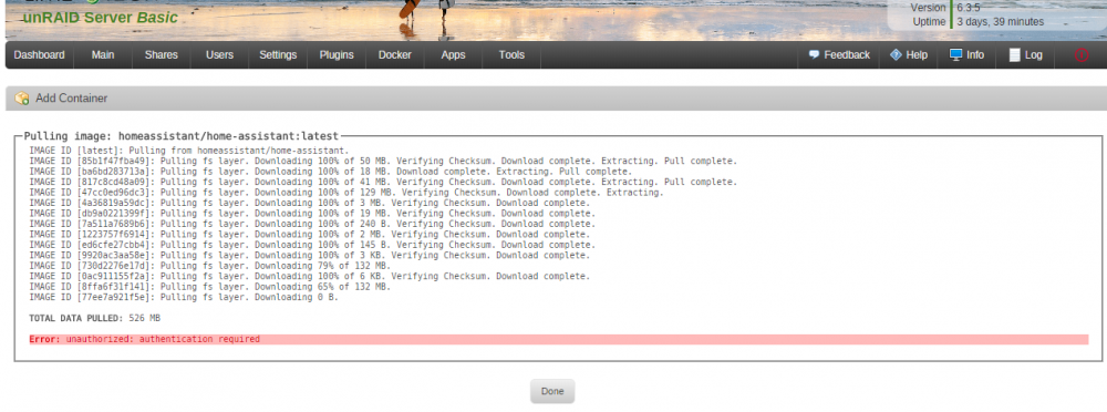

Trying to add Home Assistant and it keeps giving me an error of 'unauthorized: authentication required'
Have added a screenshot below.
Thanks!
Any chance your date and time on the server is out to lunch?
