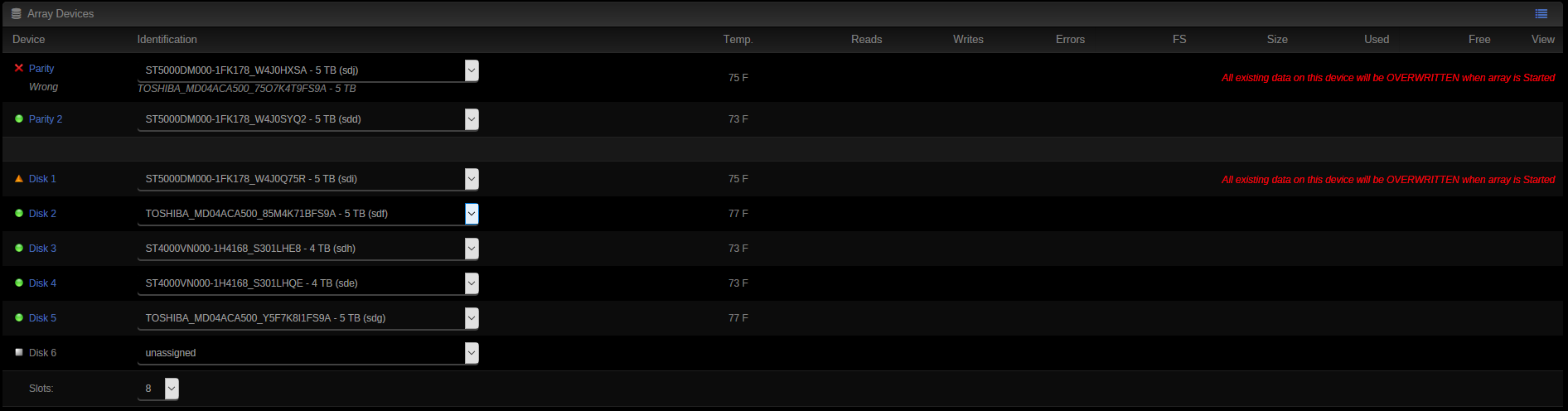

So i got 2 replacement drives 5tb. Last night I was going to replace Disk1 first and rebuild the array, then replace Parity2 and rebuild it again. Not sure what happened after i installed Disk1, but when I powered it up, Parit1 caught fire and melted the Sata connector from the power supply. Im not sure whether or not Parity1 is actually damaged beyond repair yet, obviously the Sata power cable melted and is, but I might be able to clean up the disk port and clean the contacts off to bring it back to life.
My questions is, since I have 2 parity drives, i can loose 2 disks and still not have any data loss. Technically Disk1 is dead, Parity1 might be and Pairty2 has some errors. What is going to be my best route to not loose any damage if its still possible? Can i use my 2 new 5tb drives for Disks1 and Parity1, and rebuild it with my a faulty parity 2?

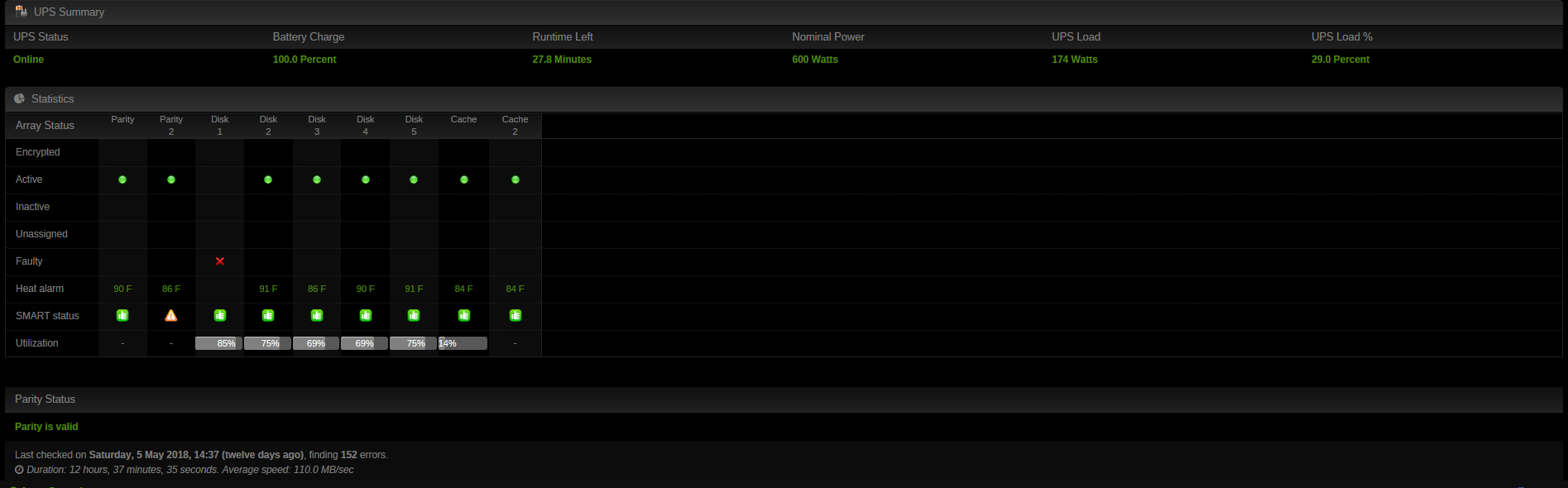

This is what my array looks like if I want to try and rebuild.

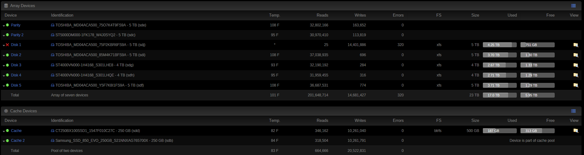

Just to follow up I was able to rebuild just fine replacing disk 1 and parity 1. Parity 1 had to be replaced because i somehow set it on fire while checking disk 1 and parity 2 inside my case, it caught fire right at the sata power port as soon as I powered it back on. I also swapped my raid controller from a pcix4 slot to my pcix16, also I moved all my raid disks to the raid controller exclusively and my 2 ssd cache drives to my 6gb/s sata ports on my gigabyte motherboard. Hoping that it might clear up my drives dropping offline from my controller.
