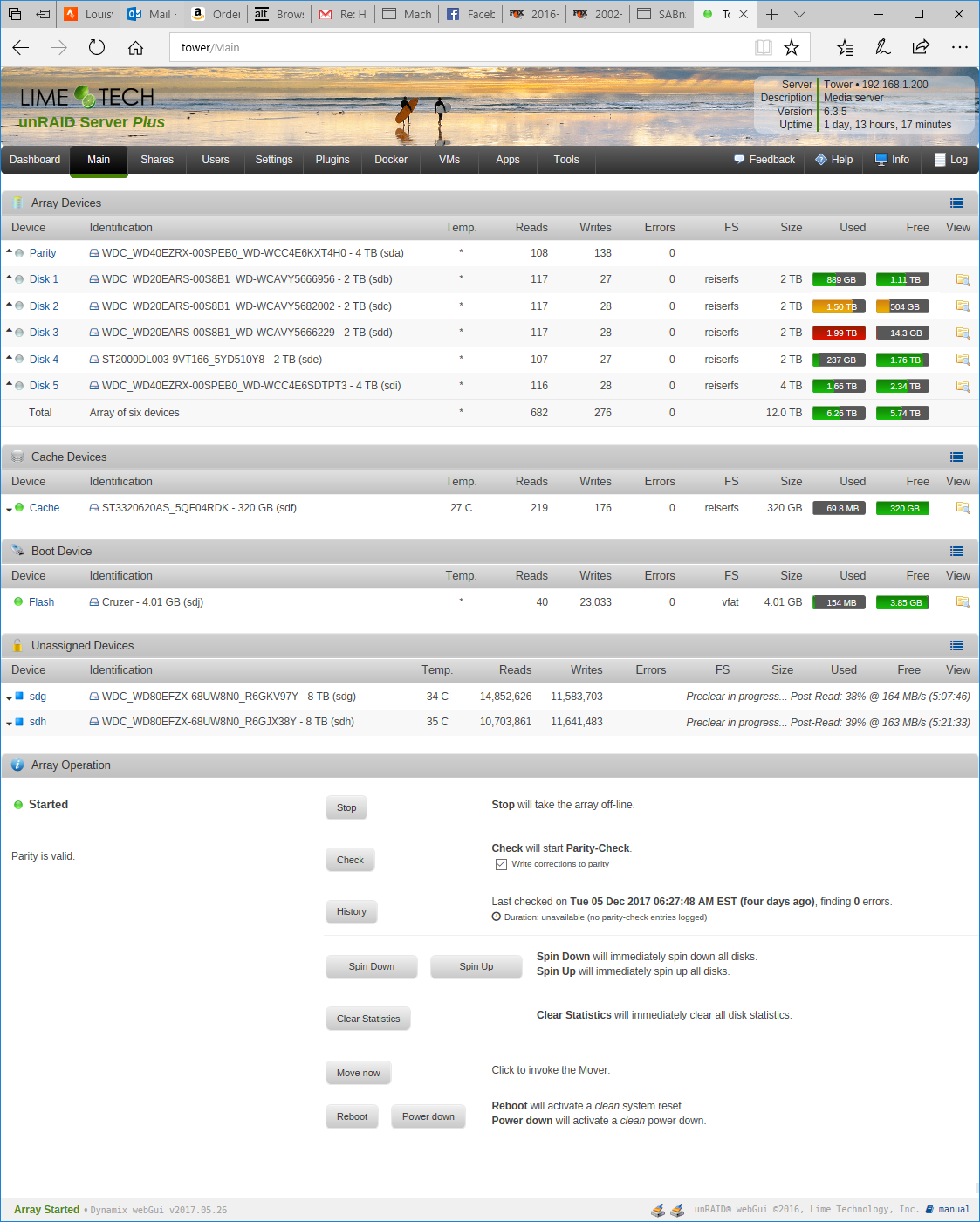

Hello guys and thanks in advance for anyone willing to share some custom advice.
Backstory is that I had my server running on version 5 for a long time with no issues.  about a week ago I starting noticing weird behavior out anything reading off of disk 5 and in the log there were lots of read errors on disk 5.  I couldn't even stream a movie.  as a test I deleted those files from disk 5 and excluded it in the share and it read fine off of the cache drive and then the next day off of another disk.  So there's still a green ball on disk 5, but it's causing me problems and I do not trust it.
I ordered a pair of 8TB WD red's and I ended up upgrading to unraid 6 so that my plus key would support more drives.  I have them preclearing now, they should finish some time late tonight.
My request for help is the order of operations for doing this upgrade and really what are my best options for the utilization of the new drives.  I have 8 physical slots in my box for drives.
I know one of the new 8TB drives will be the new Parity, the rest is kind of up in the air.
The simplest would seem to be
1. replace parity drive and let it rebuild
2. replace disk 5 with the new 8tb data drive and let it rebuild
3. preclear the old parity drive, and replace one of the older 2TB drives with it or just add it in as a new data drive.

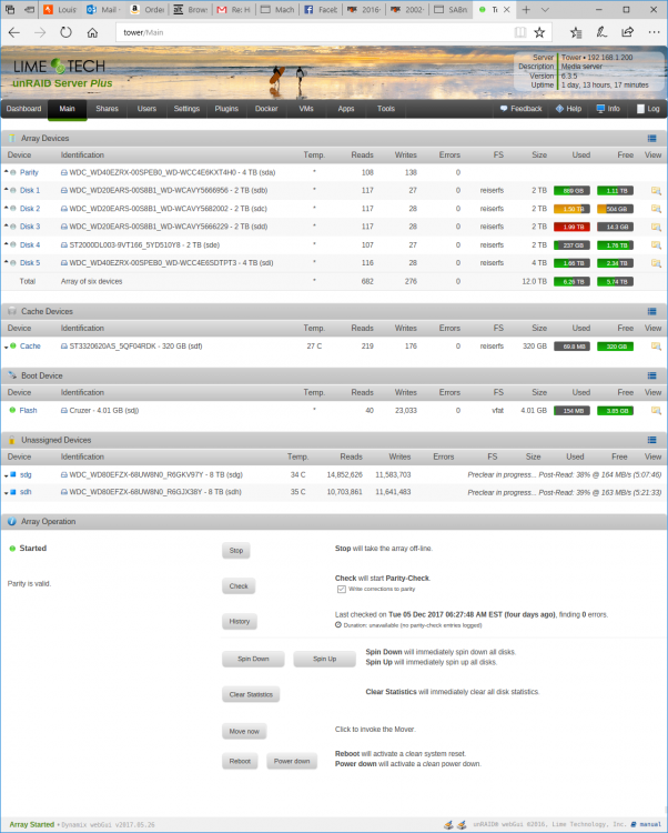

I have some free space on some of these other drives though.  Please see the screenshot below.  It seems as if I could move everything from disk 5 to disk 4 and remove it from the array, then add in the new 8 as a new drive with the newer file system.  would there be any benefit to that?
I'm curious what some of you experienced guys would do in my situation?
Thanks!
Luke
If disk5 is really bad you may have problems replacing the parity drive, you could use the parity swap procedure, but without the diagnostics it's just guessing.

Dec  5 03:20:28 Tower kernel: md: disk5 read error, sector=7687989744
Dec  5 03:20:28 Tower kernel: md: disk5 read error, sector=7687989752
Dec  5 03:20:28 Tower kernel: md: disk5 read error, sector=7687989760
Dec  5 03:20:28 Tower kernel: md: disk5 read error, sector=7687989768
Dec  5 03:20:28 Tower kernel: md: disk5 read error, sector=7687989776
Dec  5 03:20:28 Tower kernel: md: disk5 read error, sector=7687989784
Dec  5 03:20:28 Tower kernel: md: disk5 read error, sector=7687989792
Dec  5 03:20:28 Tower kernel: md: disk5 read error, sector=7687989800
Dec  5 03:20:28 Tower kernel: md: disk5 read error, sector=7687989808
Dec  5 03:20:28 Tower kernel: md: disk5 read error, sector=7687989816
Dec  5 03:20:28 Tower kernel: md: disk5 read error, sector=7687989824
Dec  5 03:20:28 Tower kernel: md: disk5 read error, sector=7687989832
Dec  5 03:20:28 Tower kernel: md: disk5 read error, sector=7687989840
Dec  5 03:20:28 Tower kernel: md: disk5 read error, sector=7687989848
Dec  5 03:20:28 Tower kernel: md: disk5 read error, sector=7687989856
Dec  5 03:20:28 Tower kernel: md: disk5 read error, sector=7687989864
Dec  5 03:20:28 Tower kernel: md: disk5 read error, sector=7687989872
Dec  5 03:20:28 Tower kernel: md: disk5 read error, sector=7687989880
Dec  5 03:20:28 Tower kernel: md: disk5 read error, sector=7687989888
Dec  5 03:20:28 Tower kernel: md: disk5 read error, sector=7687989896
Dec  5 03:20:28 Tower kernel: md: disk5 read error, sector=7687989904
Dec  5 03:20:28 Tower kernel: md: disk5 read error, sector=7687989912
Dec  5 03:20:28 Tower kernel: md: disk5 read error, sector=7687989920
Dec  5 03:20:28 Tower kernel: md: disk5 read error, sector=7687989928
Dec  5 03:20:28 Tower kernel: md: disk5 read error, sector=7687989936
Dec  5 03:20:28 Tower kernel: md: disk5 read error, sector=7687989944
Dec  5 03:20:28 Tower kernel: md: disk5 read error, sector=7687989952
Dec  5 03:20:28 Tower kernel: md: disk5 read error, sector=7687989960
Dec  5 03:20:28 Tower kernel: md: disk5 read error, sector=7687989968
Dec  5 03:20:28 Tower kernel: md: disk5 read error, sector=7687989976
Dec  5 03:20:28 Tower kernel: md: disk5 read error, sector=7687989984
Dec  5 03:20:28 Tower kernel: md: disk5 read error, sector=7687989992
Dec  5 03:20:28 Tower kernel: md: disk5 read error, sector=7687990000
Dec  5 03:20:28 Tower kernel: md: disk5 read error, sector=7687990008
Dec  5 03:20:28 Tower kernel: md: disk5 read error, sector=7687990016
Dec  5 03:20:28 Tower kernel: md: disk5 read error, sector=7687990024
Dec  5 03:20:28 Tower kernel: md: disk5 read error, sector=7687990032
Dec  5 03:20:28 Tower kernel: md: disk5 read error, sector=7687990040
Dec  5 03:40:01 Tower logger: mover started
Dec  5 03:40:01 Tower logger: skipping */
Dec  5 03:40:01 Tower logger: mover finished
Dec  5 03:47:07 Tower sSMTP[15972]: Sent mail for root@localhost (221 2.0.0 dnvrco-cmomta02 cmsmtp closing connection) uid=0 username=root outbytes=1555
Dec  5 04:50:27 Tower sSMTP[16118]: Sent mail for root@localhost (221 2.0.0 dnvrco-cmomta01 cmsmtp closing connection) uid=0 username=root outbytes=1555
Dec  5 05:47:05 Tower sSMTP[16242]: Sent mail for root@localhost (221 2.0.0 dnvrco-cmomta03 cmsmtp closing connection) uid=0 username=root outbytes=1555
Dec  5 06:27:10 Tower kernel: mdcmd (58): nocheck
Dec  5 06:27:25 Tower kernel: md: md_do_sync: got signal, exit...
Dec  5 06:27:48 Tower kernel: md: recovery thread sync completion status: -4
Dec  5 07:27:18 Tower kernel: mdcmd (59): spindown 0
Dec  5 07:27:19 Tower kernel: mdcmd (60): spindown 5

It's OK for now, but these are a very bad sign on WD drives:
1 Raw_Read_Error_Rate     0x002f   192   192   051    Pre-fail  Always       -       126204
200 Multi_Zone_Error_Rate   0x0008   001   001   000    Old_age   Offline      -       91707
They should be 0 for an healthy WD drive, it did pass the extend test so looks fine for now but likely has slow sectors that will fail in the near future.
Well, I've certainly suspected something going on with this particular disk, I don't mind getting it out of there, my current disk 1 also has a couple of reallocated sectors as well so that could be another one that gets replaced being that I have 2 8TB drives ready to go in.
This leads me to my original post about what would be the best order of operations of doing this?
I'm also thiking about doing some hardware upgrades also.  My old gaming machine is collecting dust and I have a Asus p8p67pro board and an I5-2500k not being used.  My current hardware is the old old recommended budget box with the semperon and 2g of memory.  I don't plan on using any of the advanced features, but it seems like I have this stuff laying around, I could use it.
If I was going to upgrade the hardware, should I just start from scratch with the 2 8tb hard drives on a new install and put the drives in one by one and copy the stuff to the new array.  I think I saw a tutorial about how to install unassigned devices and copy over.
Edited by VFRLuke
Hello guys, I wanted to bump this as I think I have my upgrade plan pretty well planned out in my mind.  I just want someone to make sure I'm not overlooking anything.
* I'm upgrading hardware, I have a cpu/mobo/memory that I will be using from my last gaming pc.
* I'm planning on putting 2 precleared 8TB drives into my old gaming PC which will hold everything on my server.
* I got a 30 day trial of another liscence and I have 2 boxes up now (no drives yet in the new box)
Here's my plan
1.  Get temporary install of unraid running on gaming machine with new hardware (done)
2.  Install 2 8G hard drives in this machine
3.  Transfer everything on my current server to that array  (what's the best way to transfer a massive amount of data between 2 unraid machines?)
4.  Take down original unraid machine and transfer the new motherboard into my current case and populate with drive I want to reuse
5.  Reformat the additional drives with the newer file system and add into array
I know that's pretty basic, but is there anything I should be careful of with the handling of the USB drives and or keys?
Thanks in advance!
Luke
