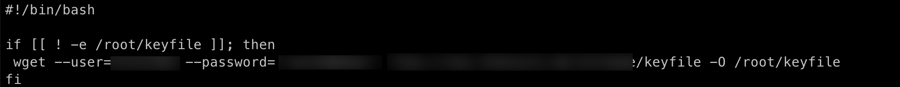

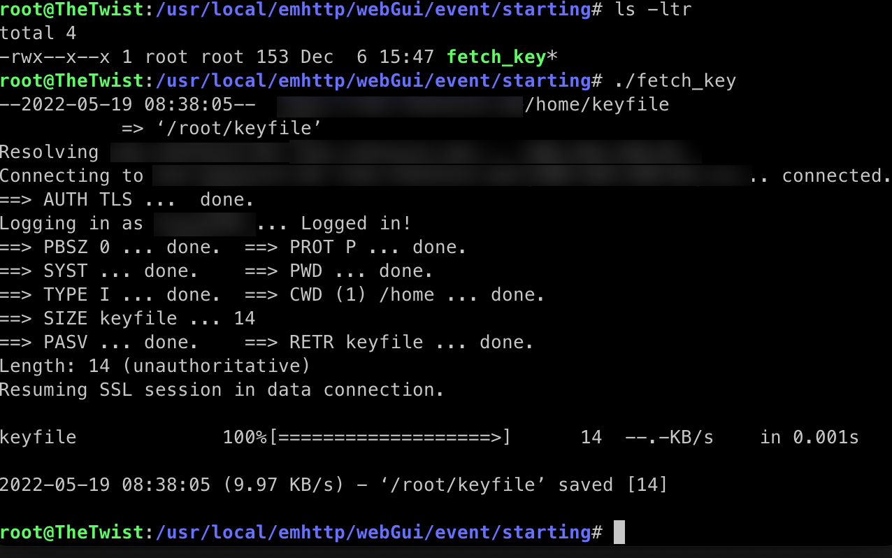

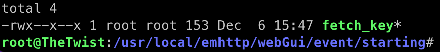

Thank you for your reply. What I have found out so far is that the scripts are in the right place. The permission is also correct. the script is not executed and therefore the keyfile is not downloaded.
If I run the script manually it works.
Under Unraid 6.9.2 this has always worked I don't changed anything since the upgrade to Unraid 6.10.
Go File (In the file events are the scripts with the correct permission)
Script fetch_key after booting Unraid (with correct permission)
fetch_key script
There is no keyfile after booting
When I run the script manually it works. It also worked without problems under Unraid 6.9.2. Since Unraid 6.10 the script fetch_key is no longer executed.
Regards
Thorsten
