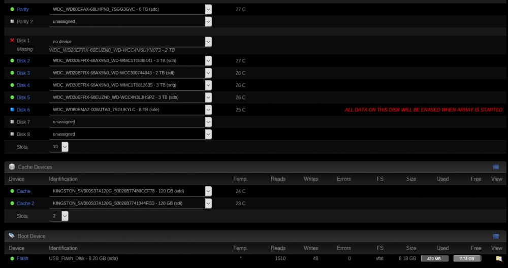

It is not letting me start my array because it is saying there is a drive missing.
I removed one of the three drives and replaced it with the new 8tb.
I started my server and now i am at where I choose what disk corresponds to what harddrive.
Disk 1 shows as missing (it is out of the server). and my new disk is set as disk 6.
what am I messing up?
Edited by dranani
Looks like you did not do a new config and keep your drive assignments.
Yeah, I meant to edit that comment. I found out what I missed and I actually just finished copying files from the three drives to the new drive using rsync.
When I out my parity back in will I want to format it and then run parity again or will unRAID be able to figure out what needs to be done if I just put my parity back in and start the array?
