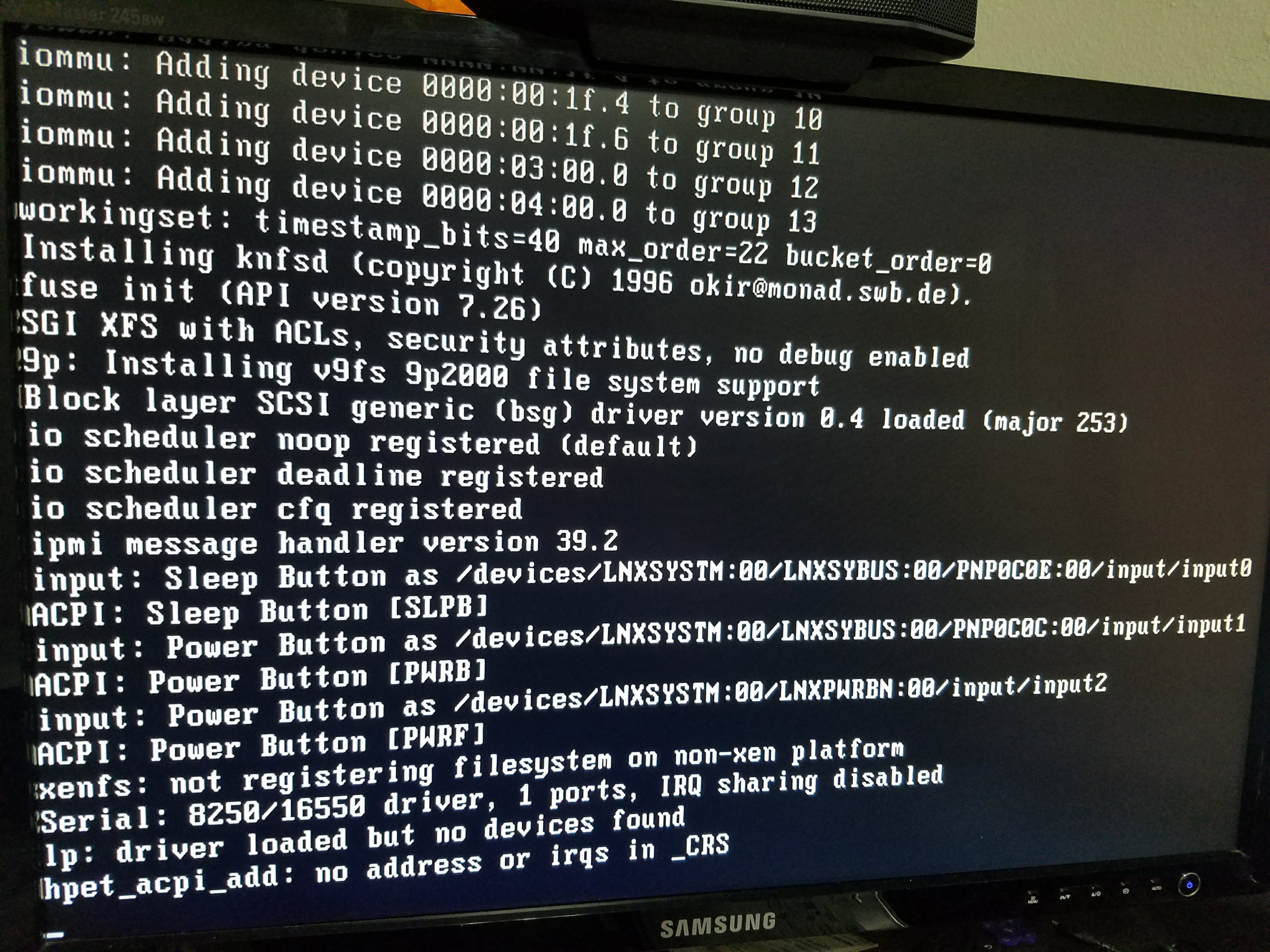

so i had a chance to try and boot up into safe mode but i keep getting a hpet_ACPI_ADD: No Address or IRQs in _CRS and the system stops booting. Attached is a Screen shot of what i am seeing.  Let me know what you guys think. Thank you for all the help.  I should also let you know i did disable the serial setting with in the bios and i am still get this error on boot in to safe mode.

Grab another flash drive, set it up for unRaid and see if it boots (you won't lose any data, etc -> we just want to see if the replacement boots up and lets the GUI be accessed)

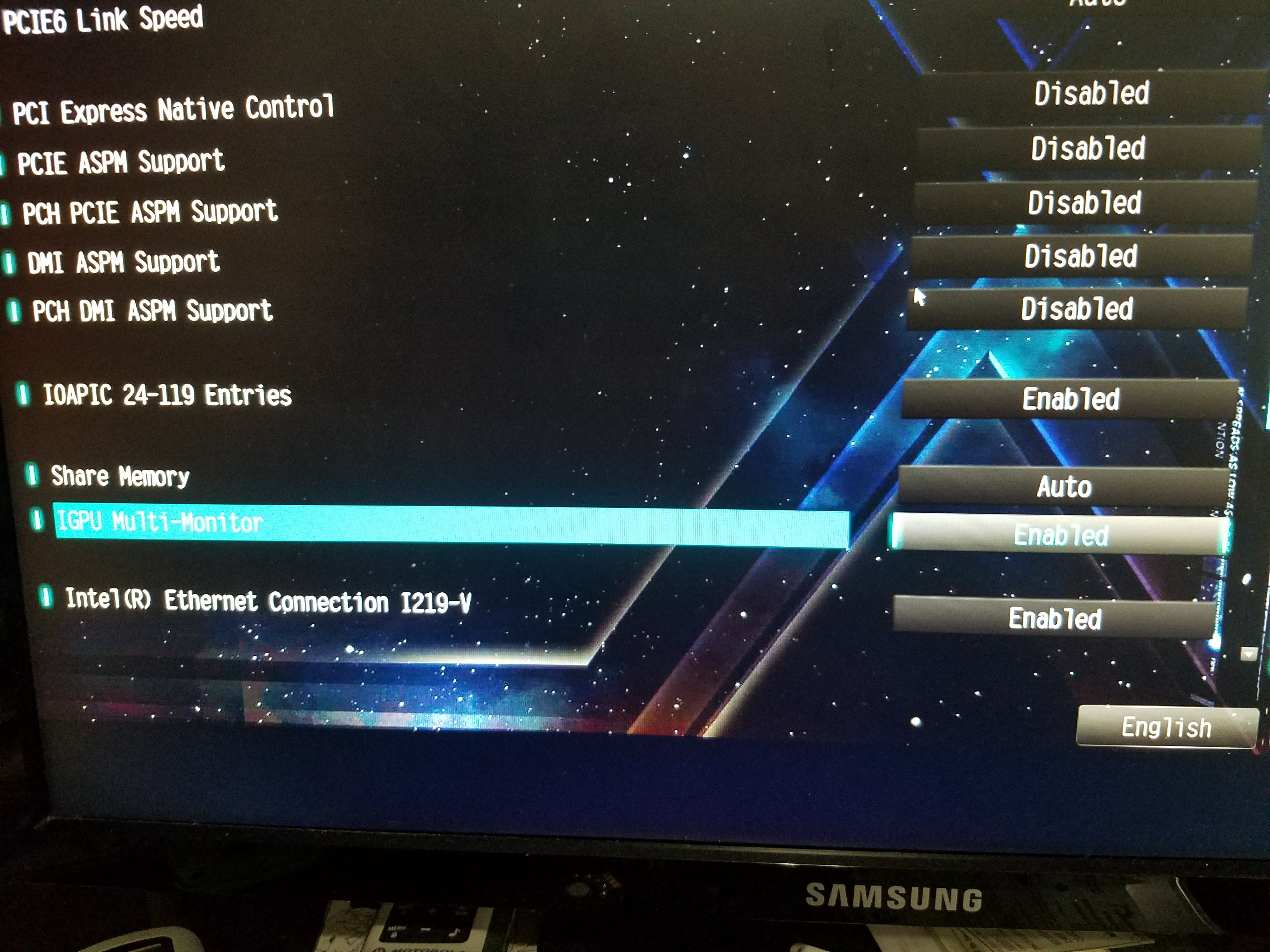

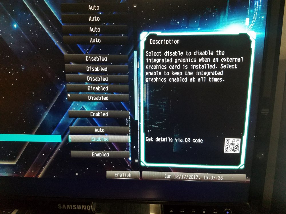

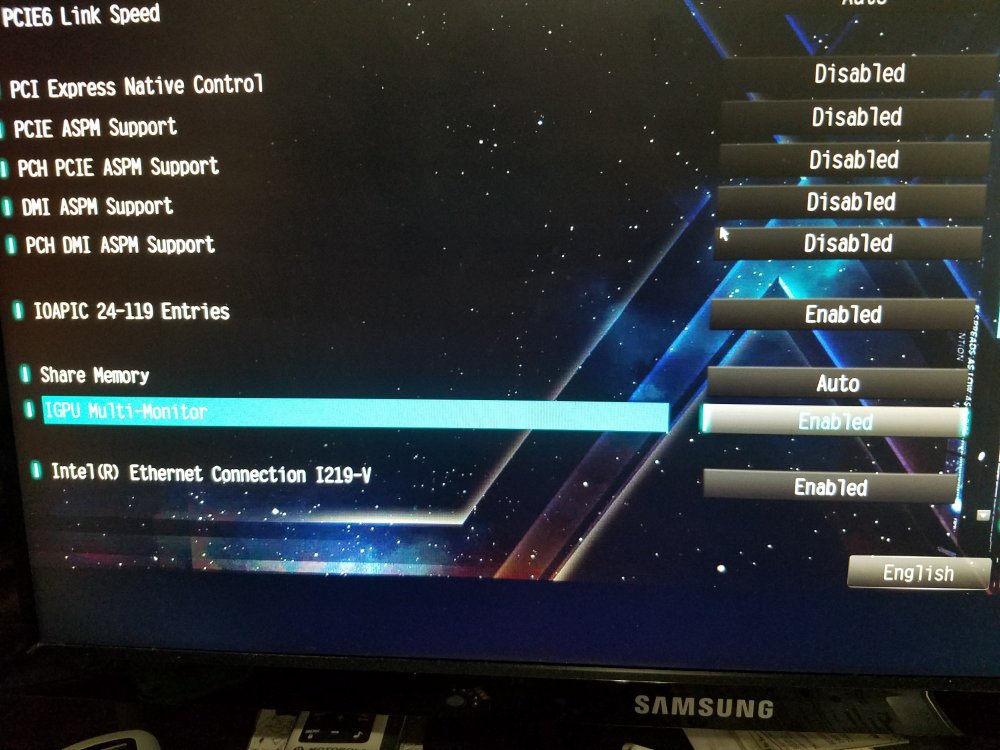

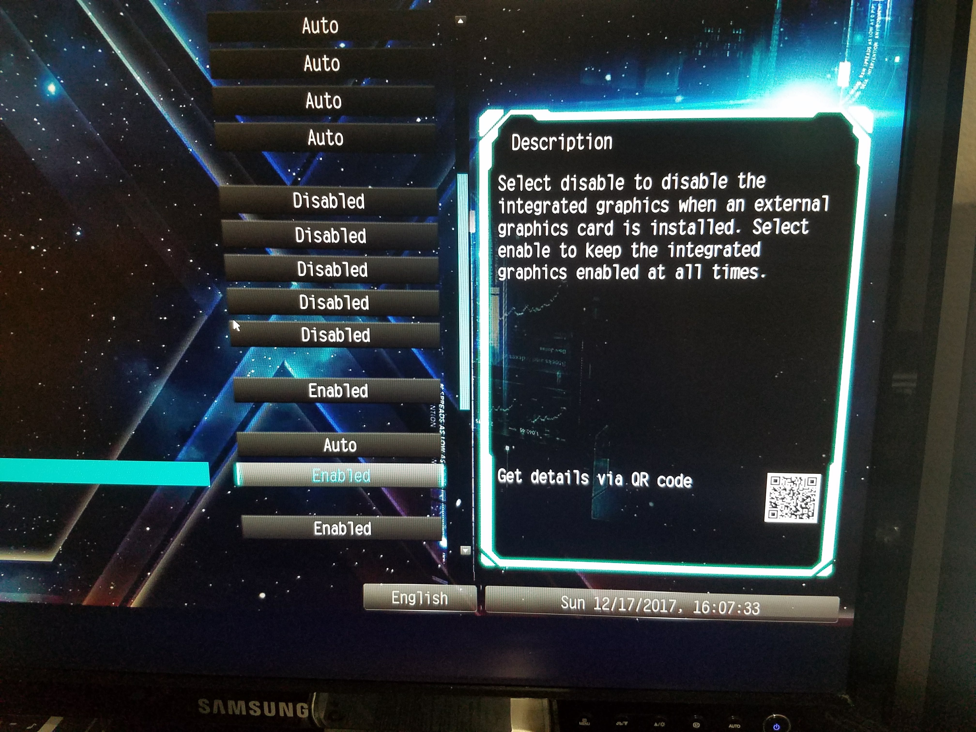

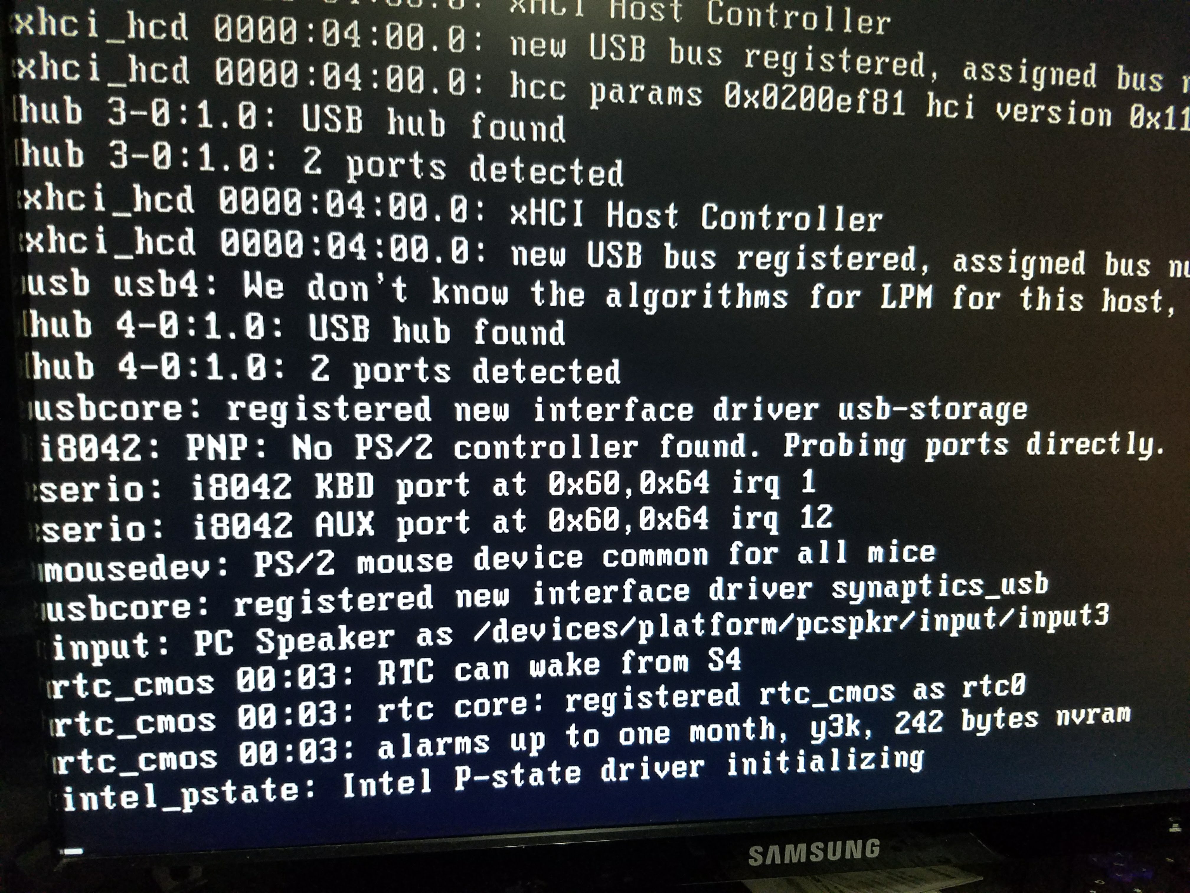

i was able to boot into safe mode.  but i had to make a few changes to get in.  after putting in the new usb Stick i was getting a Intel_pstate: Intel P-Sate Driver initializing and it would hang.  so i when i was looking in the BIos i found a IGPU Multi Monitor Setting that was disabled so i enabled it and it booted me into Safe mode in unraid.  attached is the setting i changed and the Error i was getting.
Booted into safe mode and the system locked up again. the Raid wasnt even loaded.  end up doing a hard shutdown.  I am wondering if i have a System board issue.
