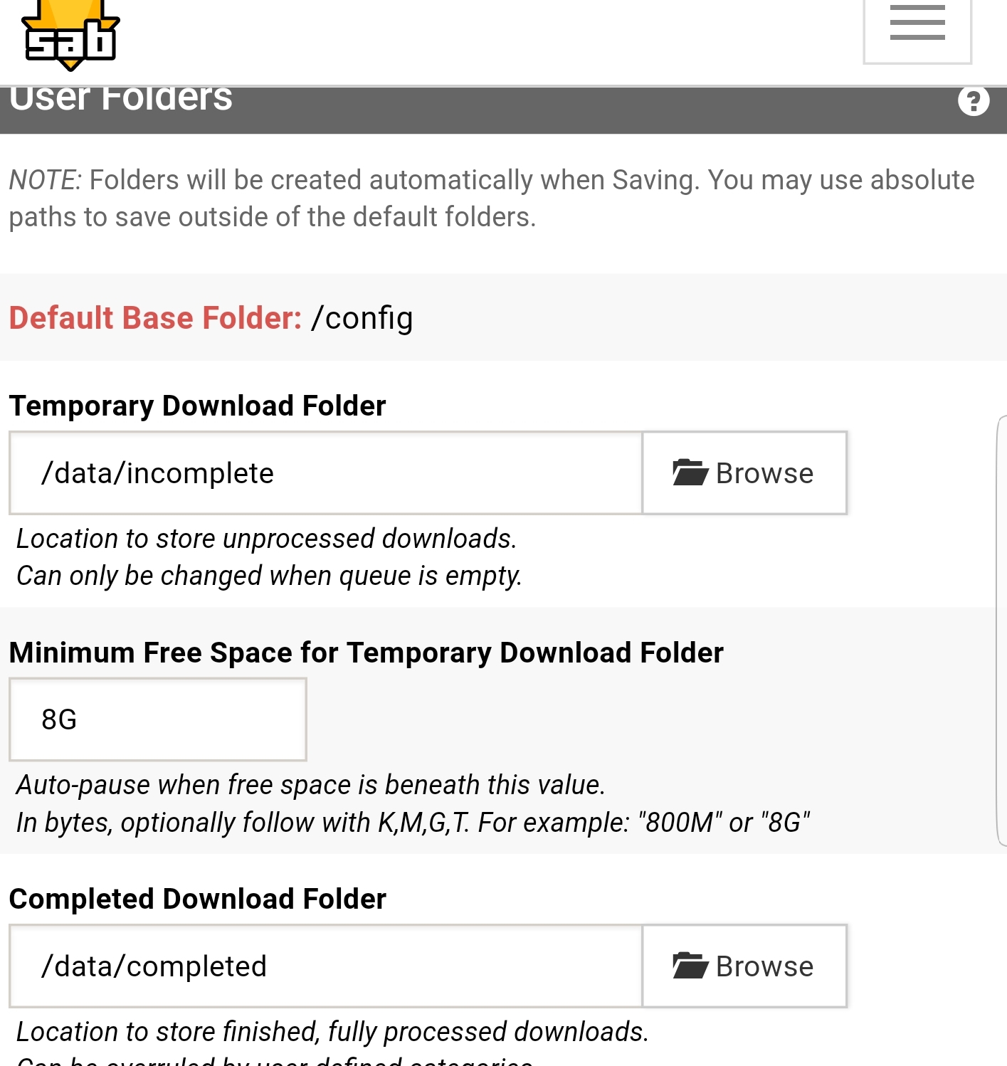

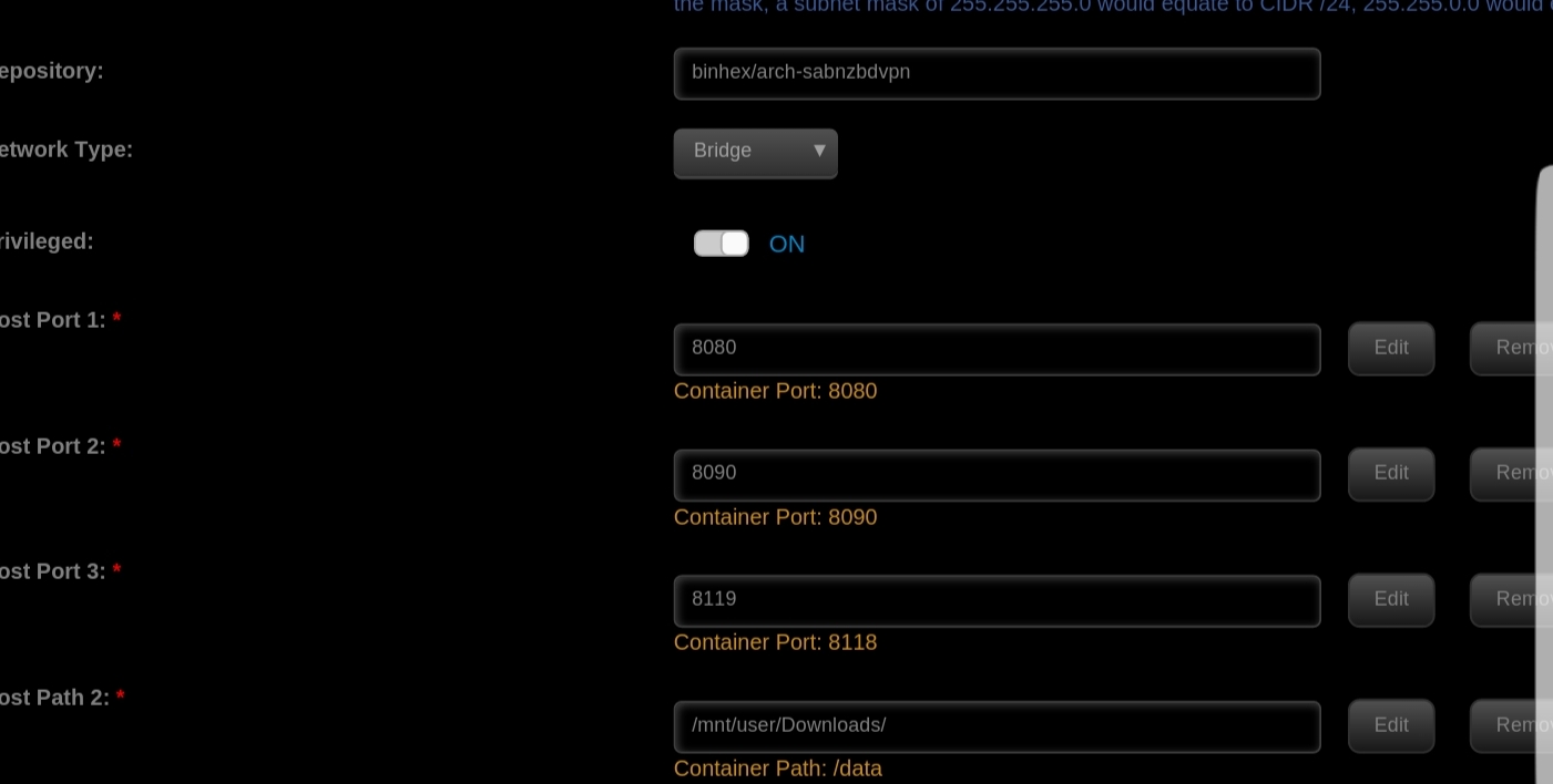

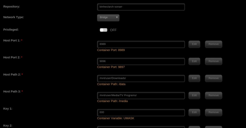

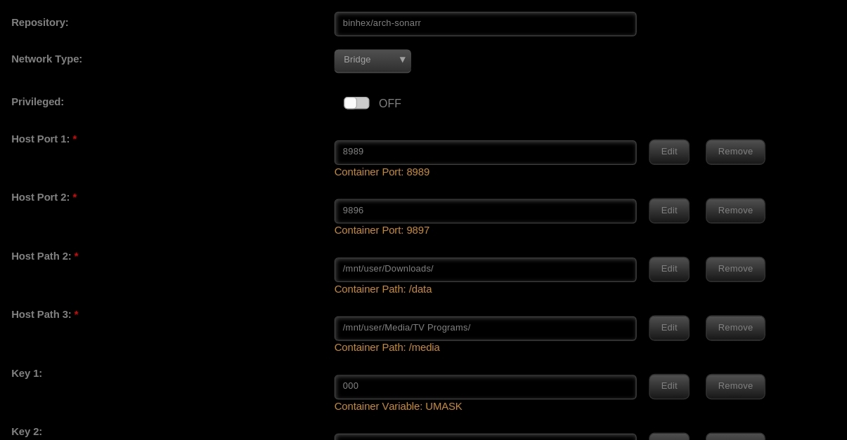

Ive attached Sabnzb and sonarr

You need to map directly to the cache, So your for your /data path, change it to:
/mnt/cache/Downloads
In the share settings, make sure you Downloads share is set to "Cache" only and on your Media share, make sure you have it set to "No" for using the cache.
Thats what solved it for me, I was previously trying to accomplish it with the same configuration you have. You also need to make sure you have no "Media" share data on the cache, otherwise that will prevent it from working. So you may need to run the mover first, because if any "Media" share data is on the cache, it will prevent it from moving it to the array...
