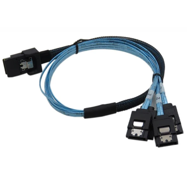

How do i connect my sata drives? If i understand correct, these cards have sas, and then?
They also work with SATA drives, and they can be found used for less than $50.
What do you mean, they work with sata drives, thats what i know, the question is how to connect them xD
OR do youi mea, i can connect sata to the sas ports? Do 9201 has 16x sata port?
Also known as a SFF-8087 Forward Breakout Cable.
Okay i found offer for <90€ so i would buy this. But please tell me how to connect my sata drives.

We just did...  To connect SATA hard drives to a controller with SAS connectors you need a SFF-8087 Forward Breakout Cable, as mentioned and pictured above.
