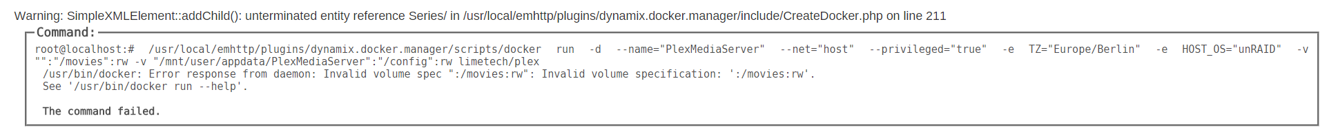

I'm trying to setup PLEX on my unRAID server I just built, I have not used PLEX or unRAID before, I am following these instructions have also watch various videos, but at the end of step 3 when I click apply after added my movie path, I just get an error.
I am using unRAID Plus 6.3.5

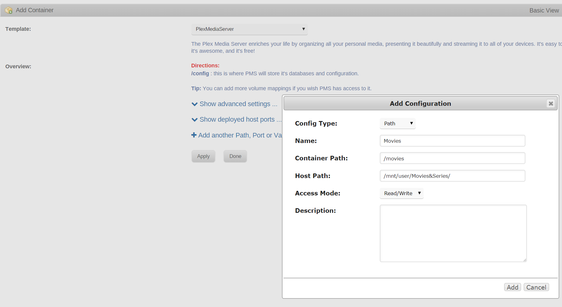

My Path that I set and the error I get:
I suspect the ‘&’ character in the host path for ‘Movies’ might be causing the parsing problem.
Known issue.  Only recourse at the moment is renaming the share to something else.
Got it fixed on my server.  Will issue a PR tonight for this.
Thanks, yep the "&" was the issue I renamed it instead to MoviesSeries and now it works.:)

Fixed for next release
