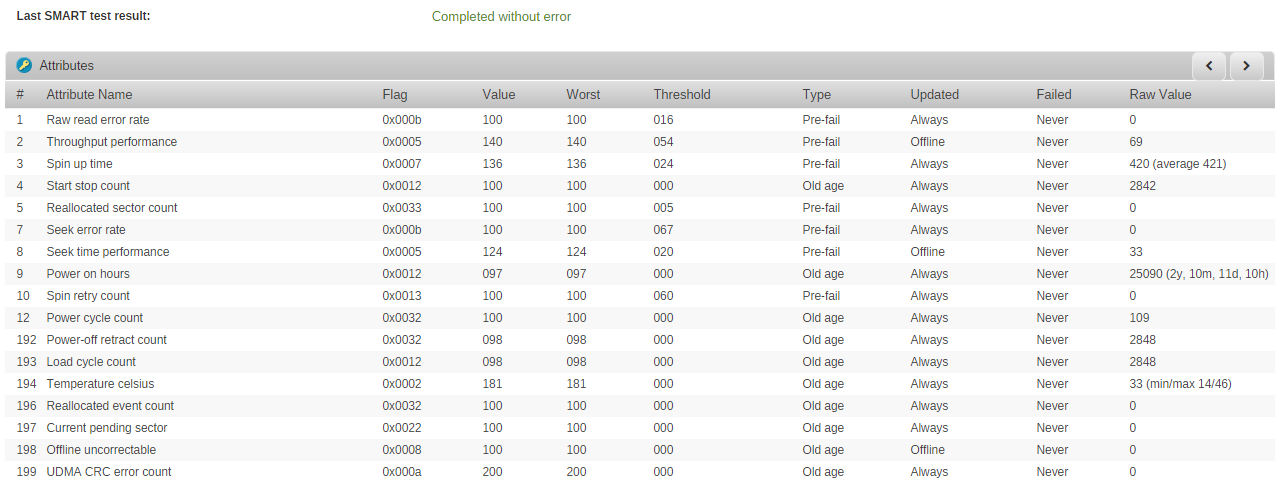

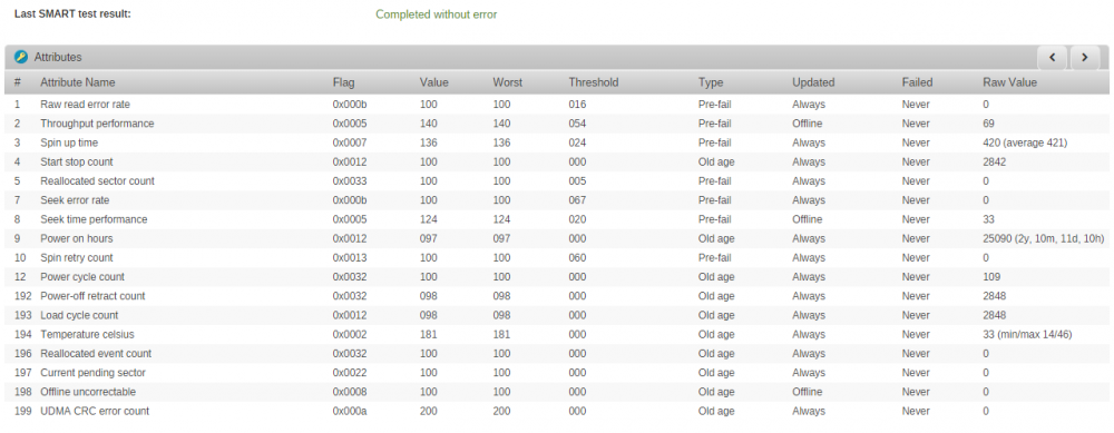

Whoa, where the parity errors come from?
So... unraid has been trudging along pretty well (granted, getting more and more full) without a reboot for the past 60+ days.
Last week I did a parity check in anticipation of receiving my first 6TB drive headed for the parity slot. The check finished without sync errors, however, tonight I just noticed the parity drive is reporting 123 errors. This isn't necessarily representative of a drive issue is it? More software?
My plan was to pull the current 3TB parity drive, plop the 6TB and begin the rebuild as soon as its 3rd pre-clear cycle completes. From there, I would bump a 2TB drive from the array, replacing it with the old parity drive.
Are these errors cause for concern? Should I do another parity check before the swap? Diagnostics attached.
diagnostics-20171211-1945.zip
Edited by TyantA
Those are read errors, and it was a disk issue, there are no pending sectors, you should run an extended SMART test.
Read errors on the parity disk.
Try to run an extended smart test on that disk. IIRC the option is available through the dashboard in the drive properties.

Home from work. So extended smart test completed without error. (See attachment)
So because there were no sync errors last week, should I be good to swap in the new parity drive as its 3rd preclear cycle finished successfully?
Edit: back to the Plex thing - it's still weird because Plex knew where it was in the new location. It's like the data reverted to the old location on the same drive and Plex wasn't made aware of that. But I haven't made changes recently, and as mentioned, I had watched episodes within the last few days that suddenly weren't there anymore. Weird.
Edited by TyantA
Even if there were sync errors you could swap since parity will be resynched.
