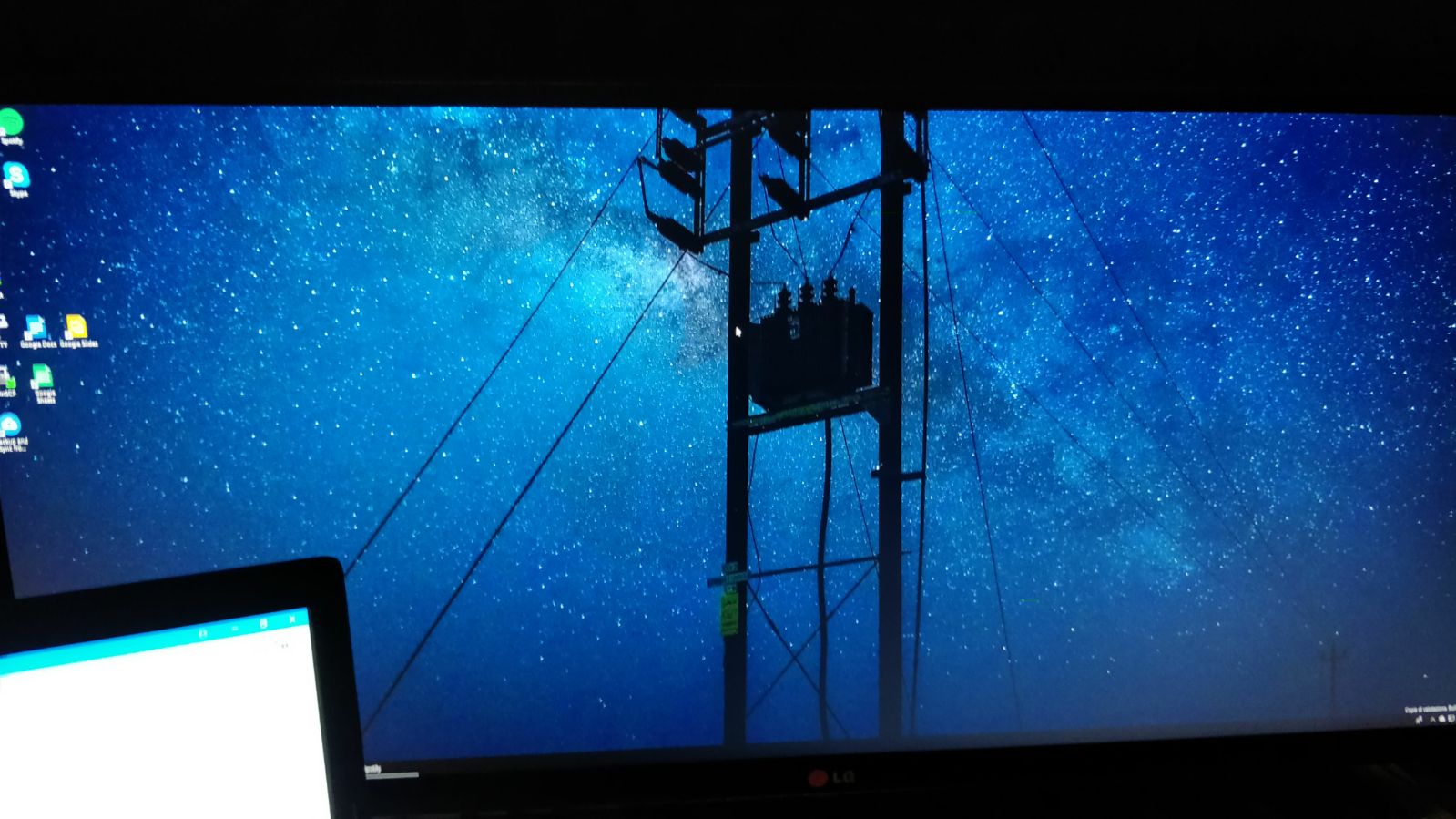

Ok a little update:
I managed to make it work now i'm trying to install the GPU drivers:
5a329670c4999_WhatsAppImage2017-12-14at16_13_15.thumb.jpeg.8558057cfd62f8e688b630dc5182e534.jpeg

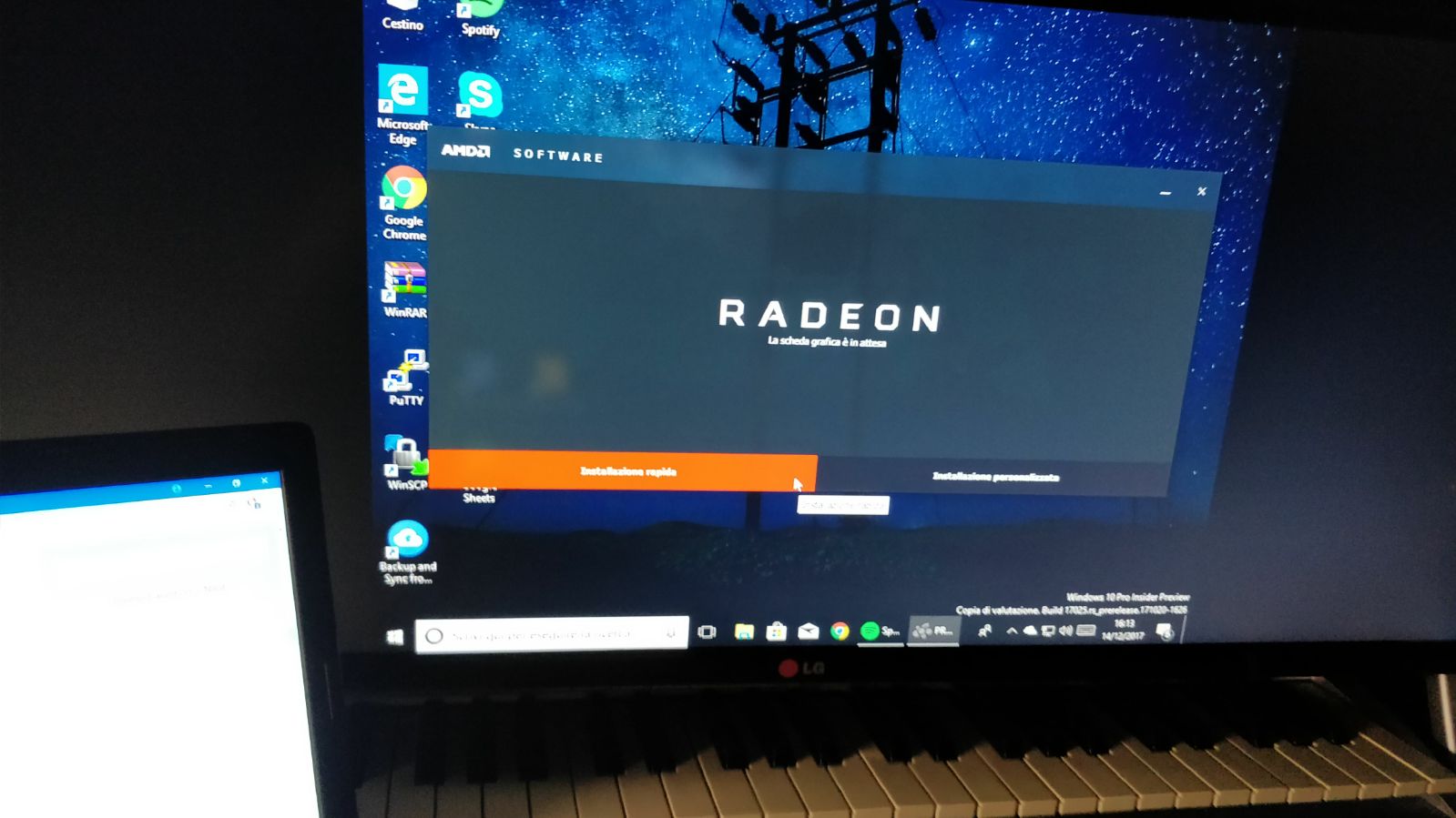

Update 2:
Ok drivers seem to work fine
5a3297a26acd4_WhatsAppImage2017-12-14at16_16_55.thumb.jpeg.9d73b2a8c632b078d9c966ac60b91d0a.jpeg
Edited by iJumbo
How did you get it to work?
I edited the kernel and recompile it using the reddit post i linked before, still crashing some times but i'm trying to make it work.
Also using this:
append video=efifb:off amd_iommu=on iommu=pt vfio_iommu_type1.allow_unsafe_interrupts=1 pcie_acs_override=downstream,multifunction rd.driver.pre=vfio-pci initrd=/bzroot
This combination made it work
