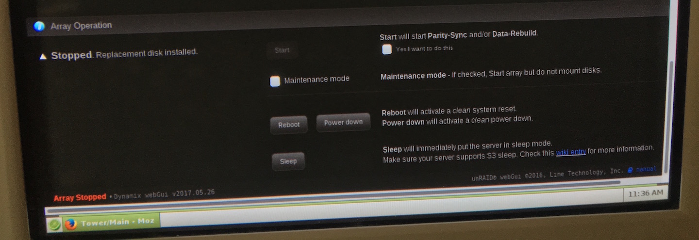

Upon reboot, I ran diags... they're attached with a couple of photos. I'm probably overthinking this, but I just want to make sure when I start the array, it will rebuild Disk 5 and keep the contents of Disk 3 emulated.
Thanks!!
Edited by Joseph
Correct

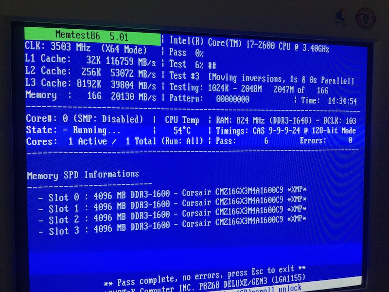

Suggest running a memory test. This is very strange symptom with counts getting so large.
running now.... will see what, if anything, it reveals... thanks.
UPDATE: I let it run overnight... 6 Passes, no errors so far.
unlikely that bad RAM would make disks drop offline, prime suspects would cabling, controller and power.

I'm going to replace the PS and see if that fixes the issue... with the holidays coming up, it might be awhile.
So, you think it might be a good idea to replace the HBA as well as the PS?
