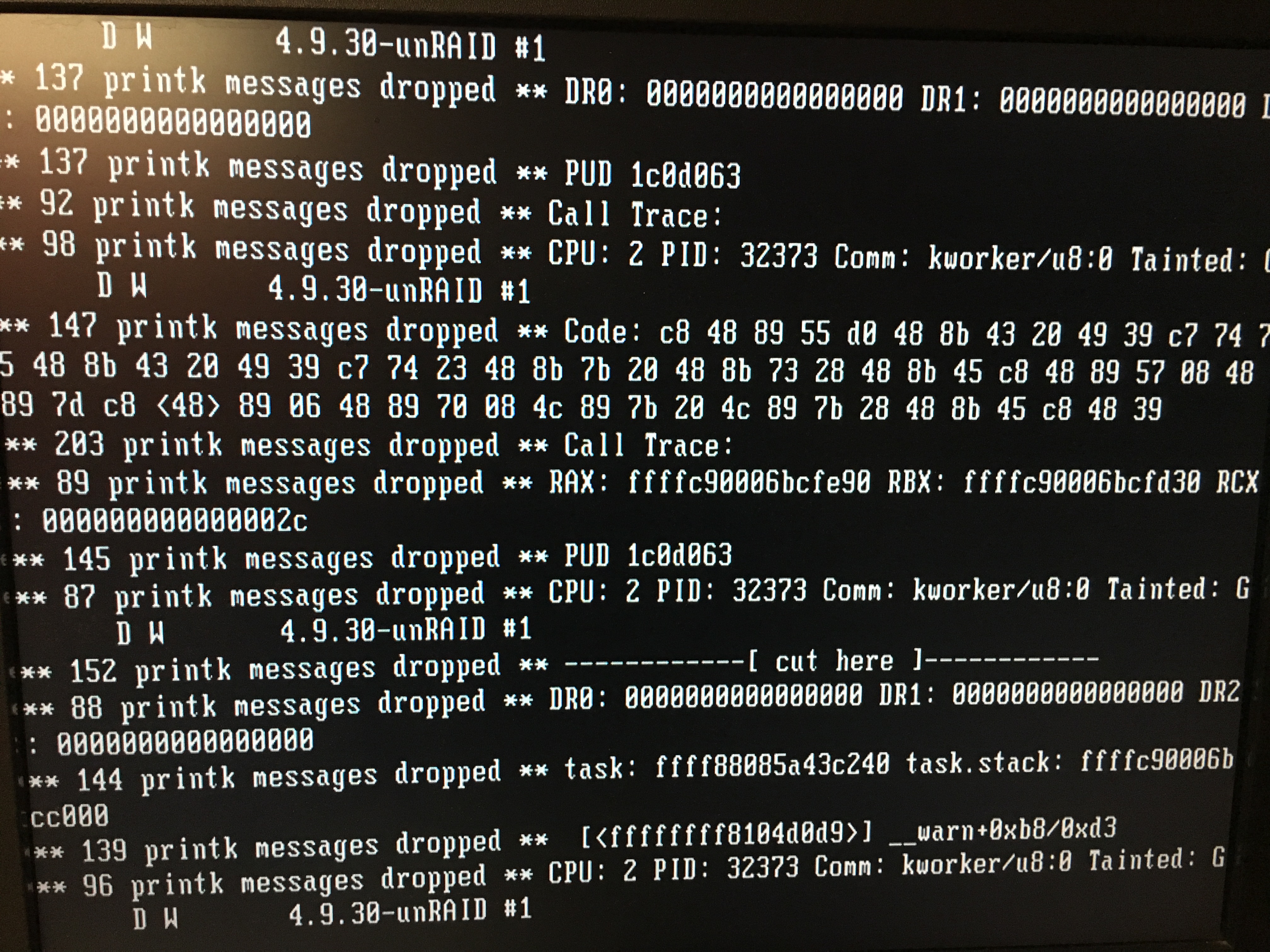

* Well, last night I had a new crash just after a scheduled file backup from inside the VM to a mapped network drive on the array was finished. Complete lockup both inside the VM and on the console. As the crash occured, i noticed the console monitor flashing all sorts of text. When it stopped typing, this is the image i got from it before once again being forced to press reset:
It seems lockups occur when the tower is doing some rather heavy read-write operations to the array. I tend to host a 7Days2Die-server inside the Win10 VM for my wife and a friend, and have always thought that hickups or crashes inside the VM would not affect the Unraid host itself. Last night I thought through this again, and then it occured to me that since the 7D2D-server is stored on the array and mapped inside my VM, the harddisk management or the intensity of read writes to the array could potentially crash the tower even if it was initiated within the VM itself.
