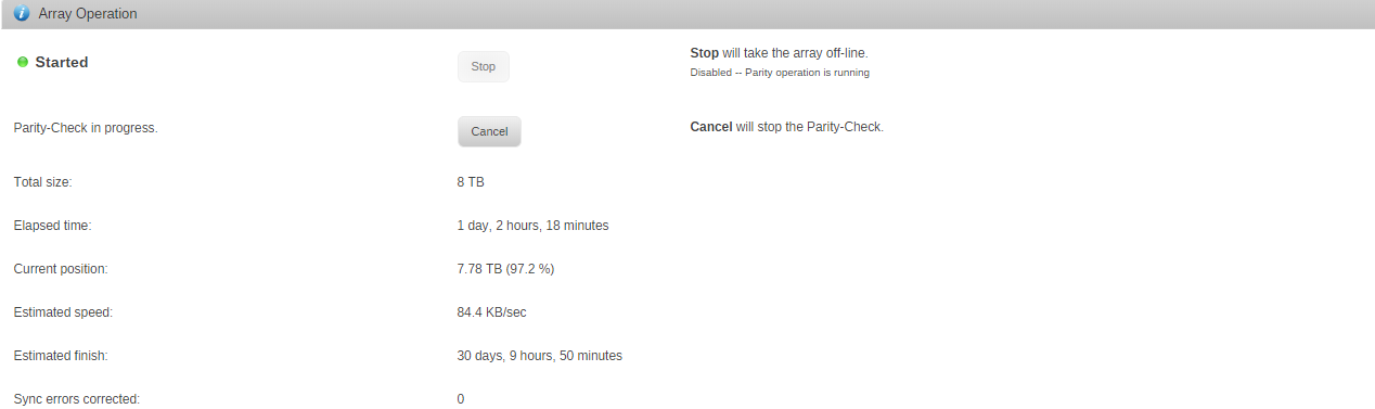

A few days ago I had what appeared to be a system lockup with the host unresponsive to ping. The system came back up and seemed to be working fine. The parity check due to unclean shutdown seemed to be proceeding apace, but was not complete when checking on it the next day. The web console has become somewhat unresponsive, the same with all docker containers and shares.
The parity check started at 124MB/sec and is now running at 84KB/sec.
I reviewed each of the drives using smartctl but see no errors. Nothing apparent on dmesg or in the system log. SSH connection hangs if I run ps after getting through part of the process list.
I kicked off diagnostics collection from the command line, but it had not completed after 5 minutes. If it eventually completes I will update this post.

Yes, I noticed the SMART issue and will have to address it, but it does not explain the slow speed of the parity check.
It took me 10 minutes, but I was able to finally disable Turbo Mode. That did not seem to improve anything.
The system finally went from 97.2% to 97.3%! I cannot wait 30-50 more days before it finishes. I am probably going to try and reboot tonight unless someone can offer another thing to try.
I am scratching my head as to why it is running so slow, without any other indicator in the logs to signify a problem.

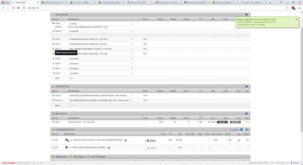

Now that I have four drives with all my data. Any pointers on recreating the array? Currently the new drive shows up as Disk 3 (drive contents emulated). I am guessing I will need to create a brand new array and slowly copy my data over drive by drive, before importing the next drive.
I just discovered New Config. It looks like I should be able to just do New Config->Retain Data and Cache slots. Then apply.
Will that work when the array thinks that disk 3 is emulated, even if disk 3 does have all the data it should? Do I have to remove that drive and then add it in separately? I assume once the array is good I would then be able to add a new parity drive and build parity.
Edited by ssb201
New config will lose any emulated disk, but didn't you un-assign parity? How do you have an emulated disk? You can also post current diags so I can see.

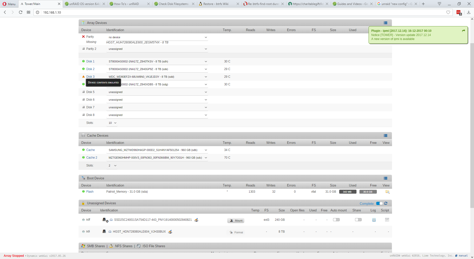

Attached. (Please note I have removed the failed parity drive and the other drive that was reporting a SMART end to end error (the one I did a BTRFS restore from).
Steps to get here:
1) Parity check slowed to crawl at 97.3%, VM running fine, Dockers unresponsive.
2) Web UI unresponsive, from SSH attempt to reboot hangs.
3) Power cycle in safe mode. System seems fine, web UI responsive and no errors showing in log. Array down.
4) Decide to replace 4TB drive showing End to End SMART error. Pull drive, put new 8TB drive in. Start array and select rebuild from parity.
5) Rebuild slows to a crawl. read errors start to appear on parity drive.
6) Cancel rebuild, reboot, confirm, parity drive is bad. (Freak a bit).
7) Put 4TB drive back in, unable to mount due to FS corruption.
8 ) Clean BTRFS format of 8TB replacement disk (since parity has started on it, a superblock and some fs was there but no data).
9) BTRFS restore almost all files from 4TB to 8TB.
10) Remove 4TB drive. As stands now I have 3 original data drives and a new copy (not clone) of the 4th data drive. No parity drive, but an array configuration expecting a parity rebuild of drive 3 (hence emulation) and a missing parity drive.
tower-diagnostics-20171216-1221.zip
OK, I think I understand now, disk3 is invalid (yellow) not emulated (red), array is in an unusual state but as long as data on disk3 looks correct if you start the array as is, without parity, you can do a new config, retain all and start the array, you can later (or now) add a new parity drive, but keep old disk3 intact in case anything goes wrong.
Correct. Apologies for any confusion,  the tooltip for the yellow says emulated:
You're right, I meant the disk status is invalid, not disabled, but without parity the disk can't be emulated, so kind of a bug, but like I said the array is in an unusual state.
