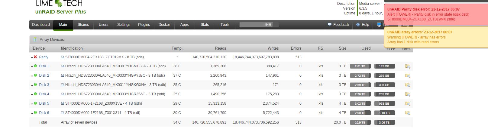

Hello,
I got a parity disk error and I don't know why or what to do.... total noob so please bear with me
This is a brand new 8tb drive that I did a preclear on... that had no errors...
tower and drive reports attached
I have done nothing since discovering error.... I don't want to make it worse
any assistance greatly appreciated.... thank you

The new 8TB parity drive appears to have dropped completely offline.  At some point you're going to have to power down, check cables and connections, and try to get that disk to come back online so we can verify its health.  Let's see if anyone can suggest steps to take before doing that, though.

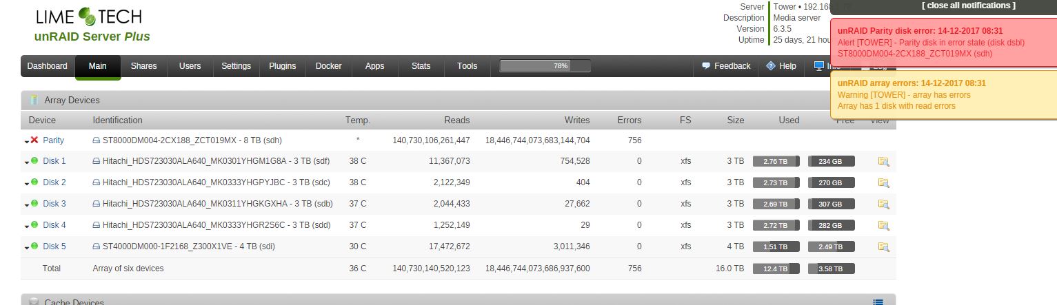

is that why the reads and writes are so high?
I really want to get this back up tonight.....
You need to reboot/power cycle so that it comes online and post new diags so there's a SMART report for that disk.

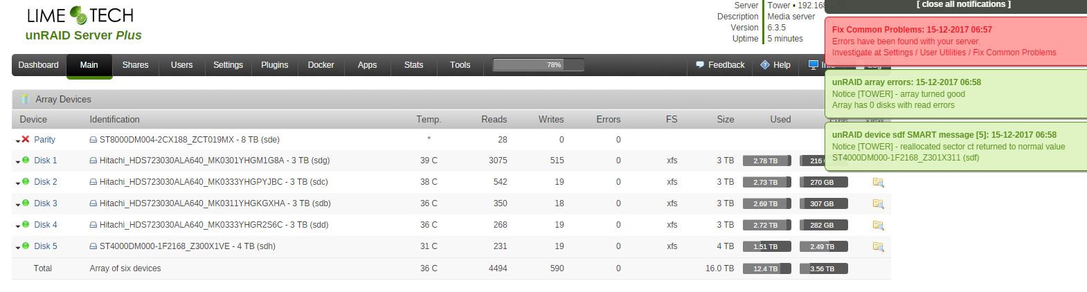

Came home at lunch and did as @johnnie.black posted..... it's currently syncing with about 15 hrs estimated to complete.... so far so good

Well I am happy to report that as of this morning it is all green dots!!!
About 20hrs to rebuild....... any theories as to why so that I can try to prevent it occurring again?

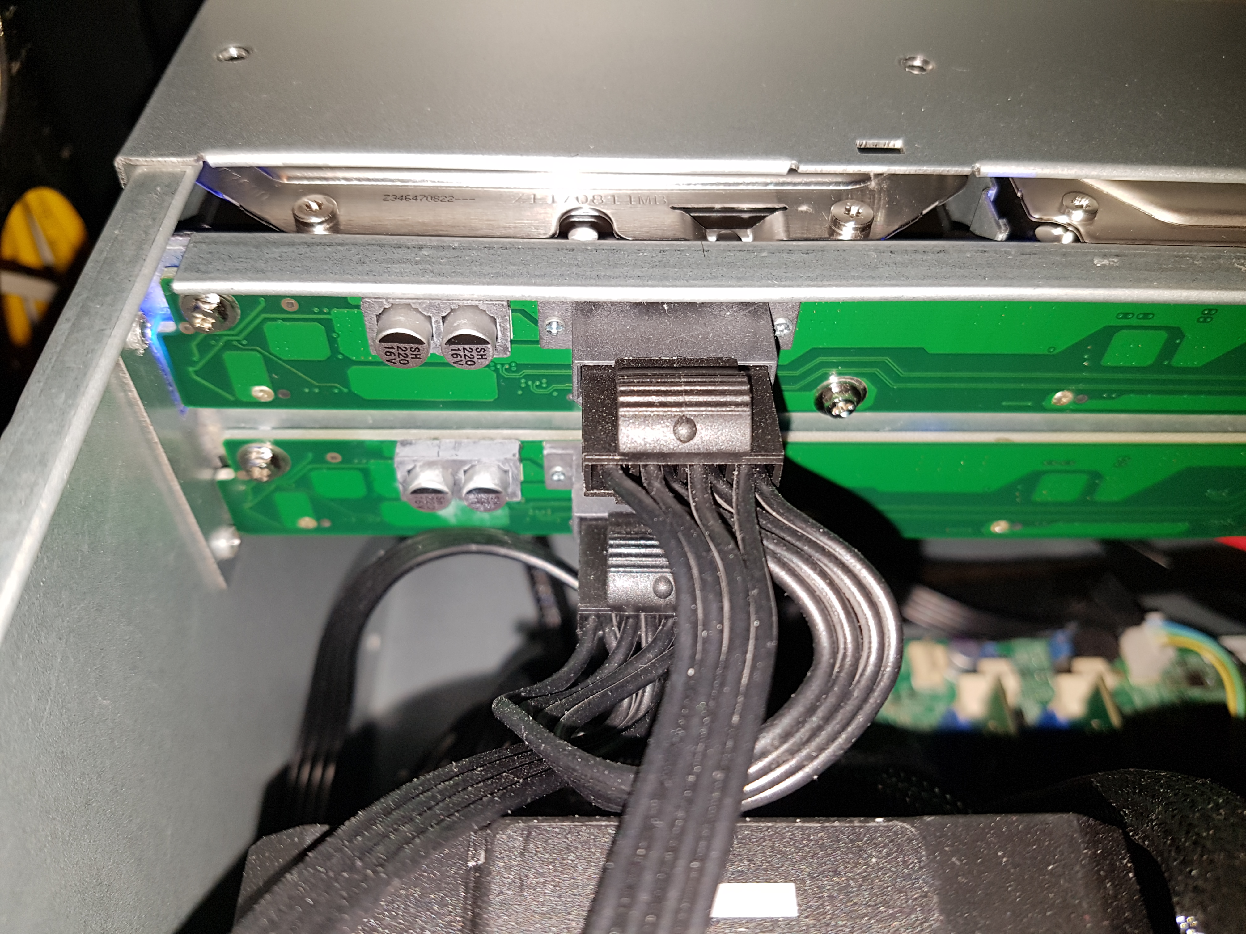

Hmm. What are you running for a power supply?
Corsair RM650i
650 watt

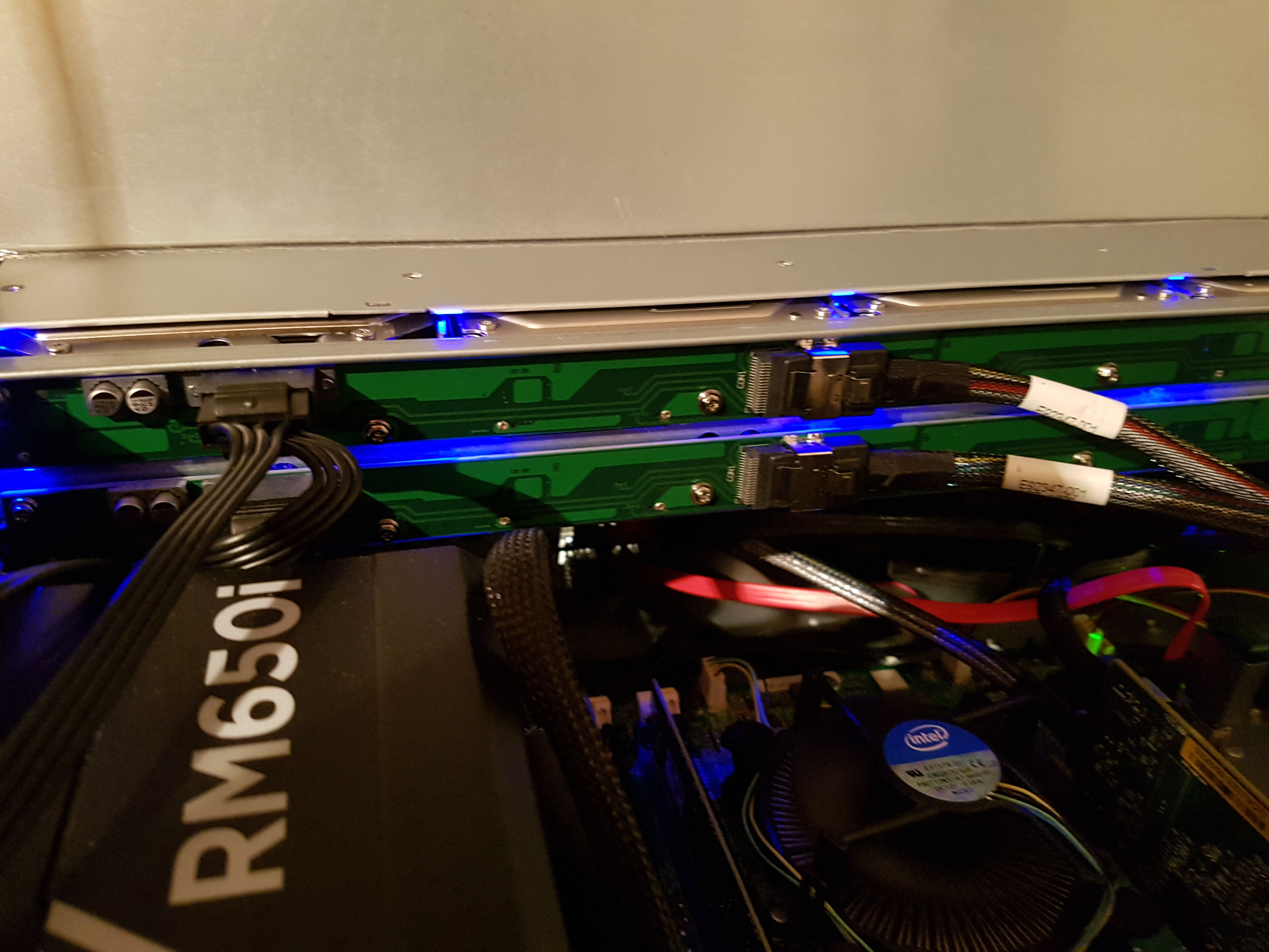

My brain is leaning toward a physical issue....
Rational being that only the one drive appears to have the issue (upper left in the pictures below)
What I am thinking is that at one point (when powered down) double check all the screws that connect the boards to the case. Maybe its loose on the left side???
My concern is that: 1) it's a dumb idea that could make things worse 2) unseating, tightening and reseating the drives will result in more errors
Any suggestions / advice is welcome
