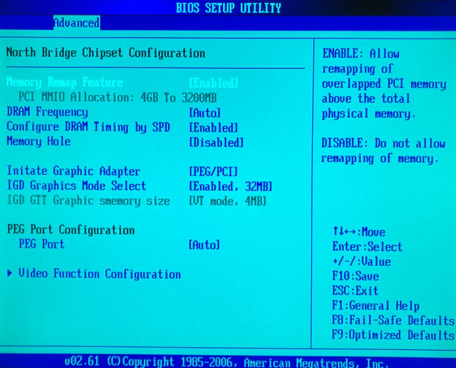

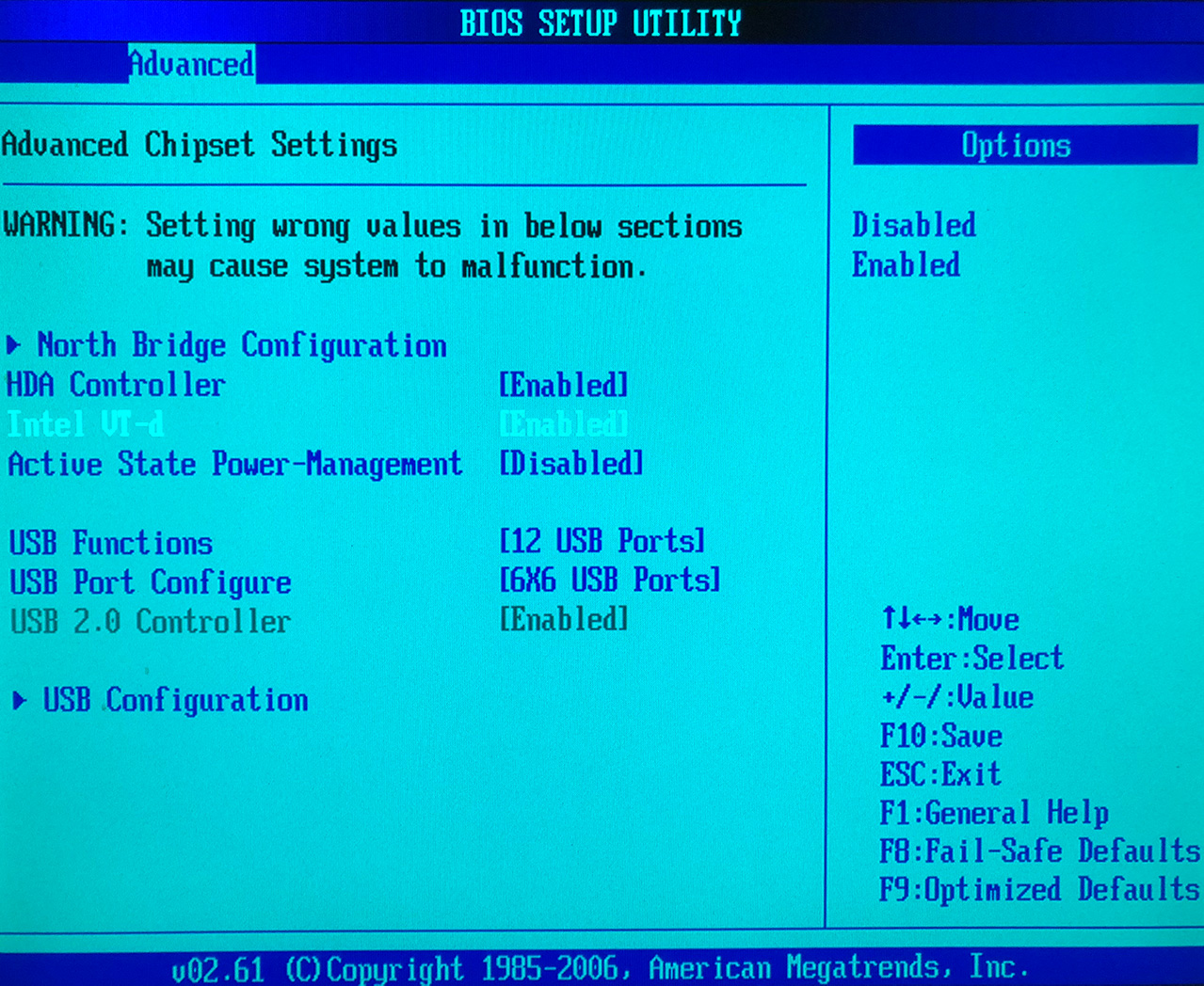

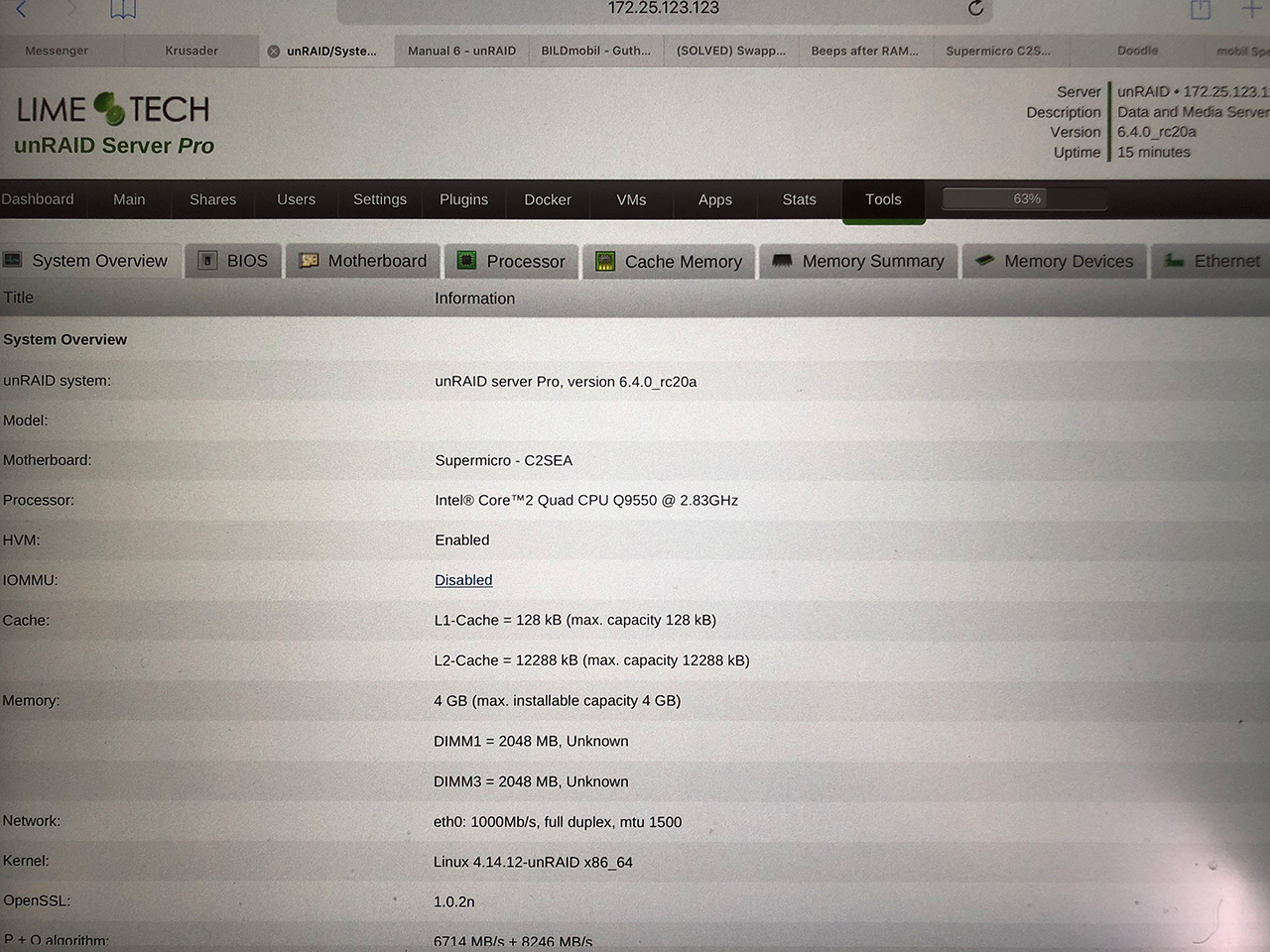

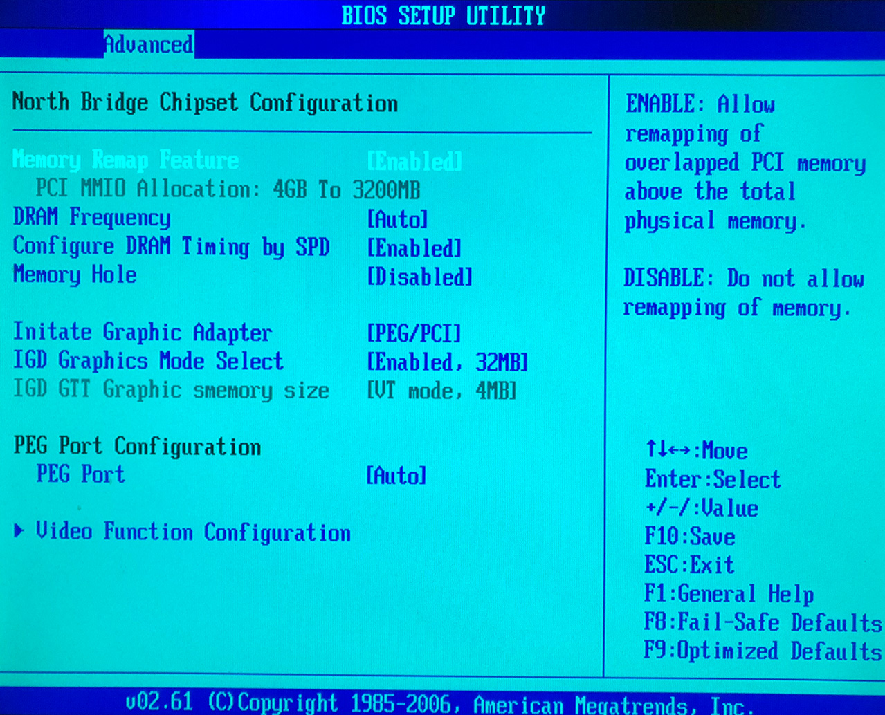

to illustrate that I am not crazy (or maybe I'm just mis-reading something?), here a few screenshots to show that:
- VT-d is Enabled in the BIOS
- there is no VT-x toggle in the North Bridge Chip Configuration panel
- the unRAID System Overview shows 4GB maximum memory (the C2SEA has 4 slots and supports 8GB)
- the unRAID System Overview shows HVM is enabled, but IOMMU is not
