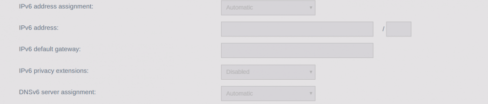

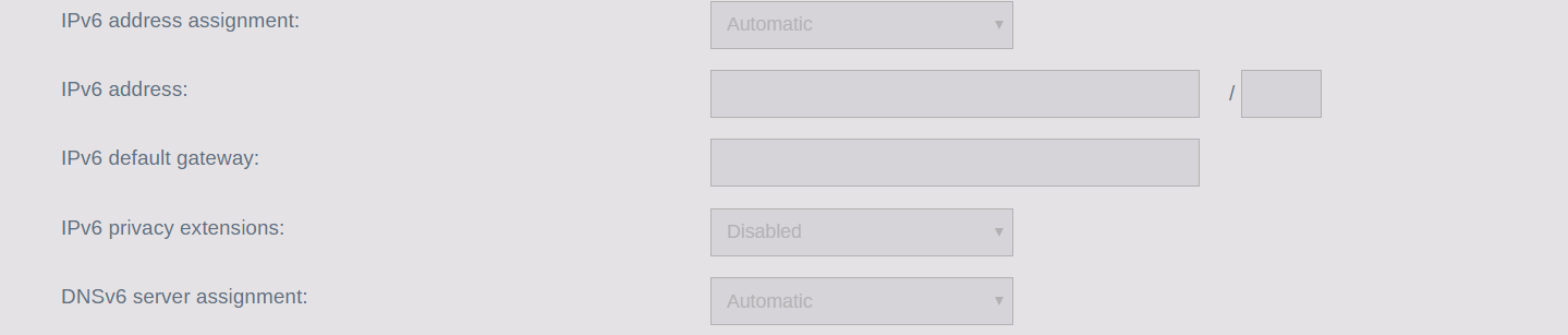

    Updated backup server to rc16b without issue so far.  I don''t run VMs on the backup/test server so I cannot comment on the fix.  My production server remains on 6.3.5.
    Of course, I still have the problem of console output disappearing over IMPI as expected. This appears to be a 4.14.4 kernel issue which I have reported to ASRock as an FYI for them.
    Neither of my servers are getting an ipv6 address.  I have network settings set for ipv4 and ipv6 to get addresses automatically.
    backupserver-diagnostics-20171215-2032.zip
    EDIT: More information:
    Output of ifconfig:
    bond0: flags=5443<UP,BROADCAST,RUNNING,PROMISC,MASTER,MULTICAST>  mtu 1500
            inet6 fe80::be5f:f4ff:febe:7ee6  prefixlen 64  scopeid 0x20<link>
            ether bc:5f:f4:be:7e:e6  txqueuelen 1000  (Ethernet)
            RX packets 2031929  bytes 2540513273 (2.3 GiB)
            RX errors 0  dropped 77  overruns 0  frame 0
            TX packets 2988  bytes 2963817 (2.8 MiB)
            TX errors 0  dropped 6 overruns 0  carrier 0  collisions 0
    br0: flags=4163<UP,BROADCAST,RUNNING,MULTICAST>  mtu 1500
            inet 192.168.1.4  netmask 255.255.255.0  broadcast 192.168.1.255
            inet6 2605:a000:1317:802a:be5f:f4ff:febe:7ee6  prefixlen 64  scopeid 0x0<global>
            inet6 fe80::2cd4:82ff:fe8a:eec3  prefixlen 64  scopeid 0x20<link>
            RX packets 7866  bytes 1276852 (1.2 MiB)
            RX errors 0  dropped 0  overruns 0  frame 0
            TX packets 1724  bytes 2893929 (2.7 MiB)
            TX errors 0  dropped 0 overruns 0  carrier 0  collisions 0
    Network gui on unRAID:
    It does look like unRAID has an ipv6 address, it's just not reporting it.
    Edited by dlandon
    In this release IPv6 hs its own settings for IP assignment and DNS. You need to re-apply the network settings to let the new settings work properly.
    That fixed it.  Would have been nice to have this indicated in the release notes.  So anyone updating from 6.3 will have this issue.
    Eh no, this issue only appears if you have configured IPv6 in an earlier 6.4 release. People updating from 6.3 will have IPv4 only and need to configure IPv6 if they want to use this.
    Ah yes.  Been on 6.4 so long, I forgot about the ipv6 stuff being added in 6.4.
