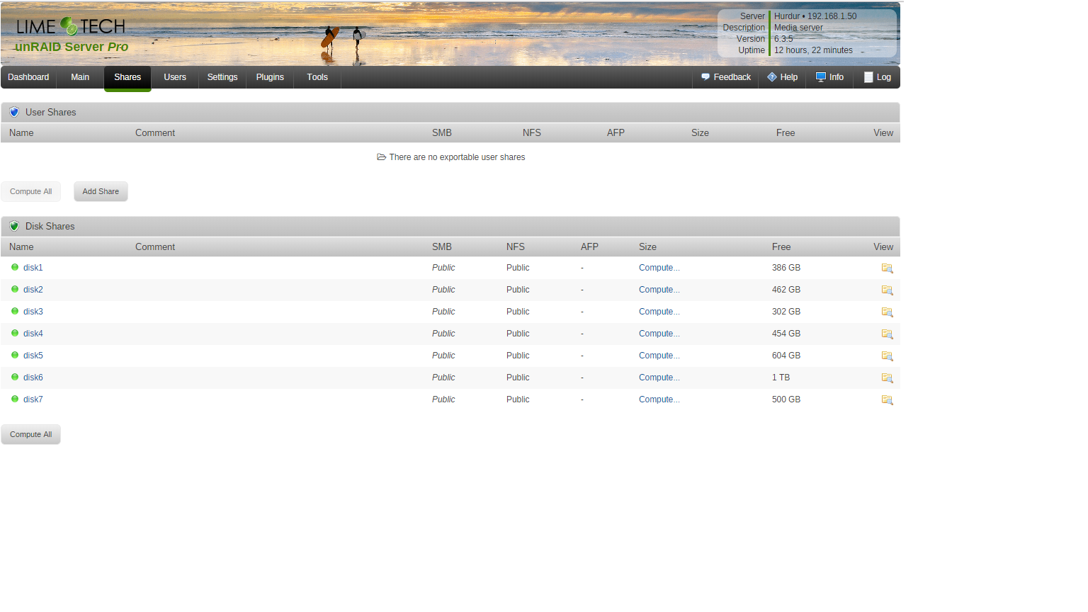

tried to whitelist and does not seem to make any difference. This is what I see in the GUI, my other computers see nothing but Flash, so even though it lists disk shares here none show up over the network.
Edit: disk shares are hidden, but even when I change them to not hidden, I get permission errors, but user shares are just not showing up at all.

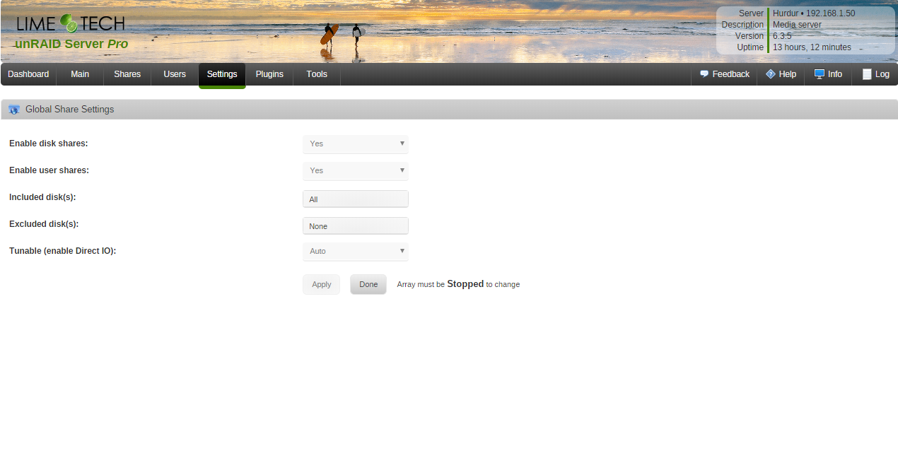

For the heck of it, can you stop the array, make a change to the global share settings, revert the change and apply and then restart to see if that makes any difference.
Occasional problems IIRC going from a 6 beta to stable that solved some problems by doing that.
I did this as I thought maybe it might change it, I turned both disk and user shares off, then back on with no change.
