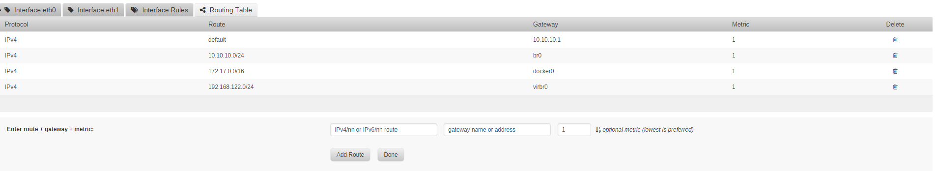

After looking at your replies, here is my network routing table. Is anything wrong here?

DelugeVPN.  Going from @vanes post, and open VPN was referenced in the traces
That is correct.
