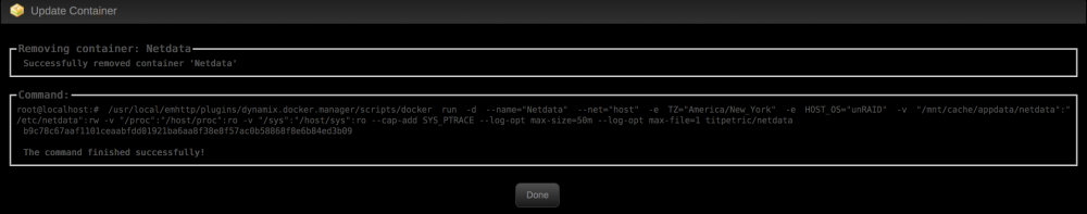

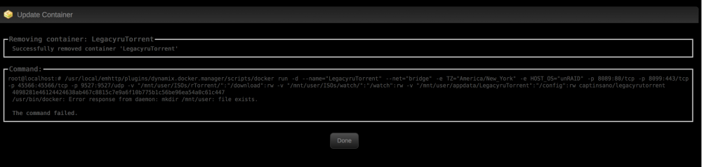

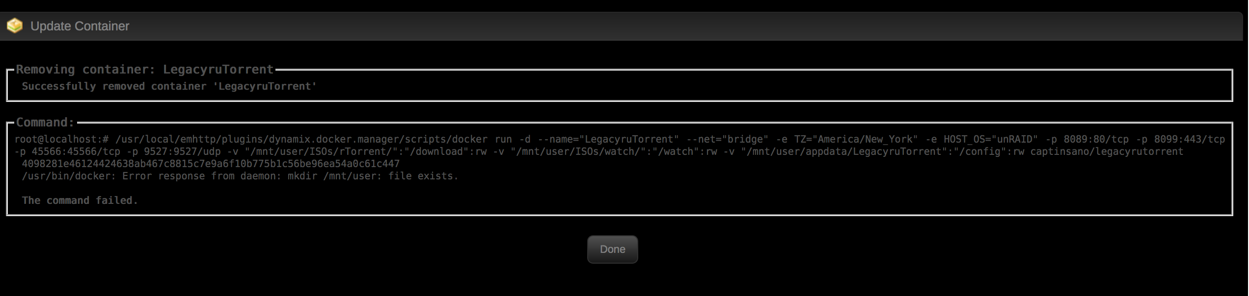

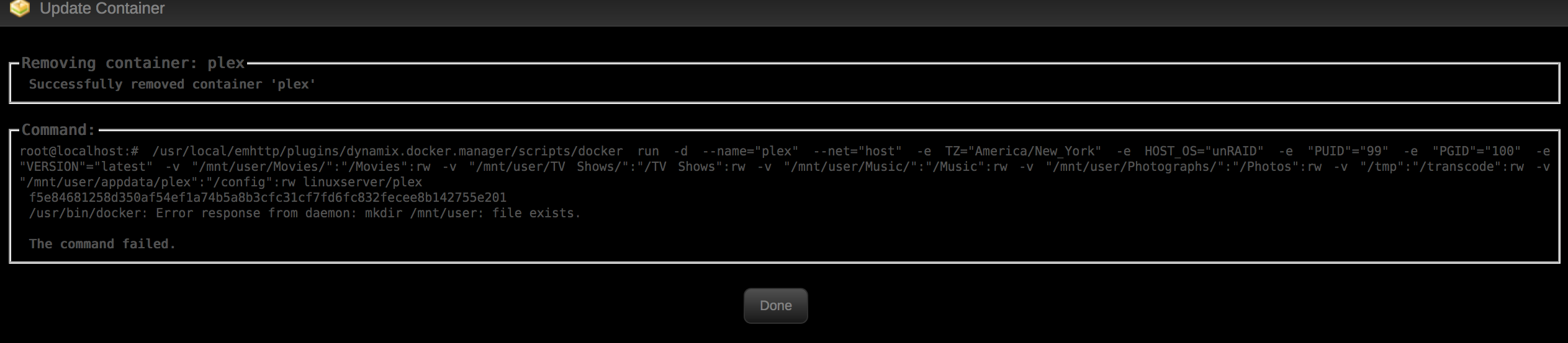

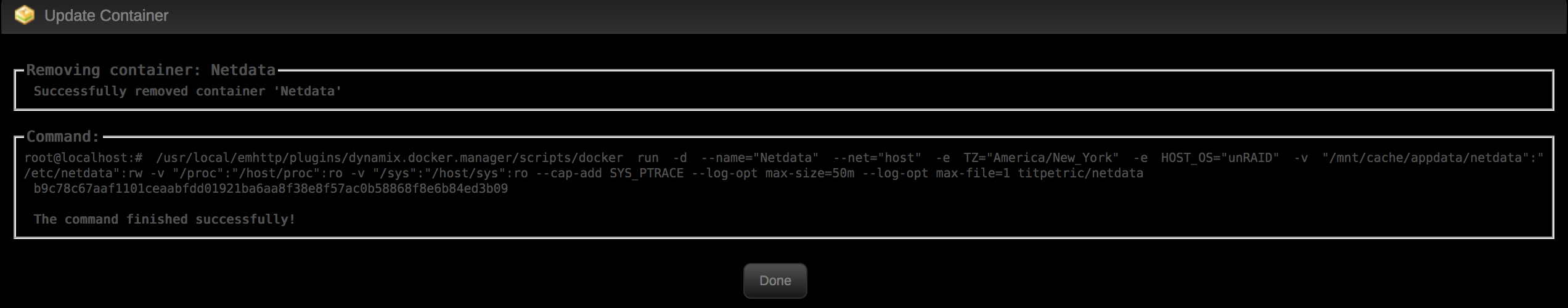

When this happens, on the docker page, edit the application, make a change any change, revert it back and then hit Apply.  Post the docker run command that appears.  The "Server Error" is just a generic pop up that starting the app failed, but the docker run command will give the details as to why.

Added a snapshot of the docker run command, see below.

here are other snapshots of docker apps in view of the above step 2
Its messed because of the killing off of processes.  Reboot is best recourse at this point.  If they don't fire back up, then post a new diagnostics
