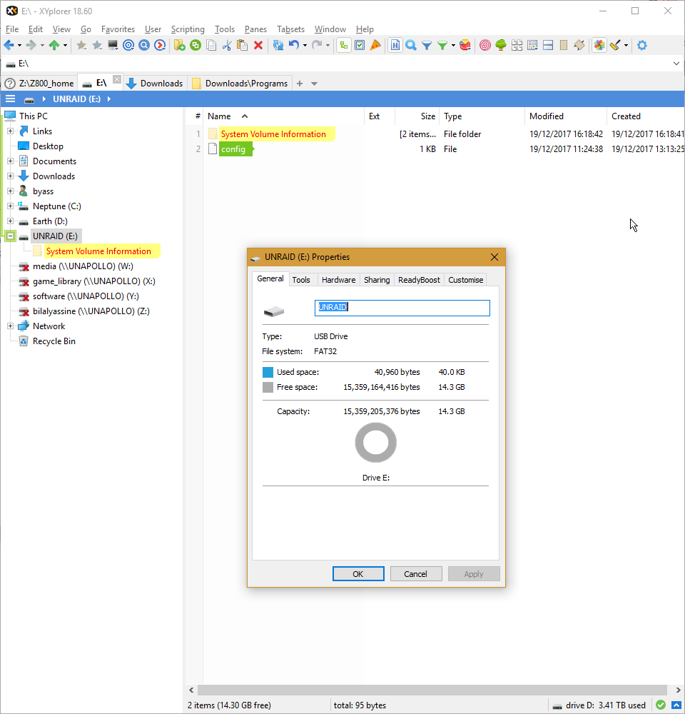

So I had a power failure at home and no UPS set up. I turned the server back on and now I am getting a message on my ipmi screen unraid failed to load ldlinux.c32.
I turned off the machine and stuck the USB flash drive into my windows 10 machine and well the screenshot explains it all. I have no idea what to do.
I am officially really worried now.
Do i re-setup the usb? my concern is that the system config will be lost or is that not a problem with unraid?
Thanks for any help.

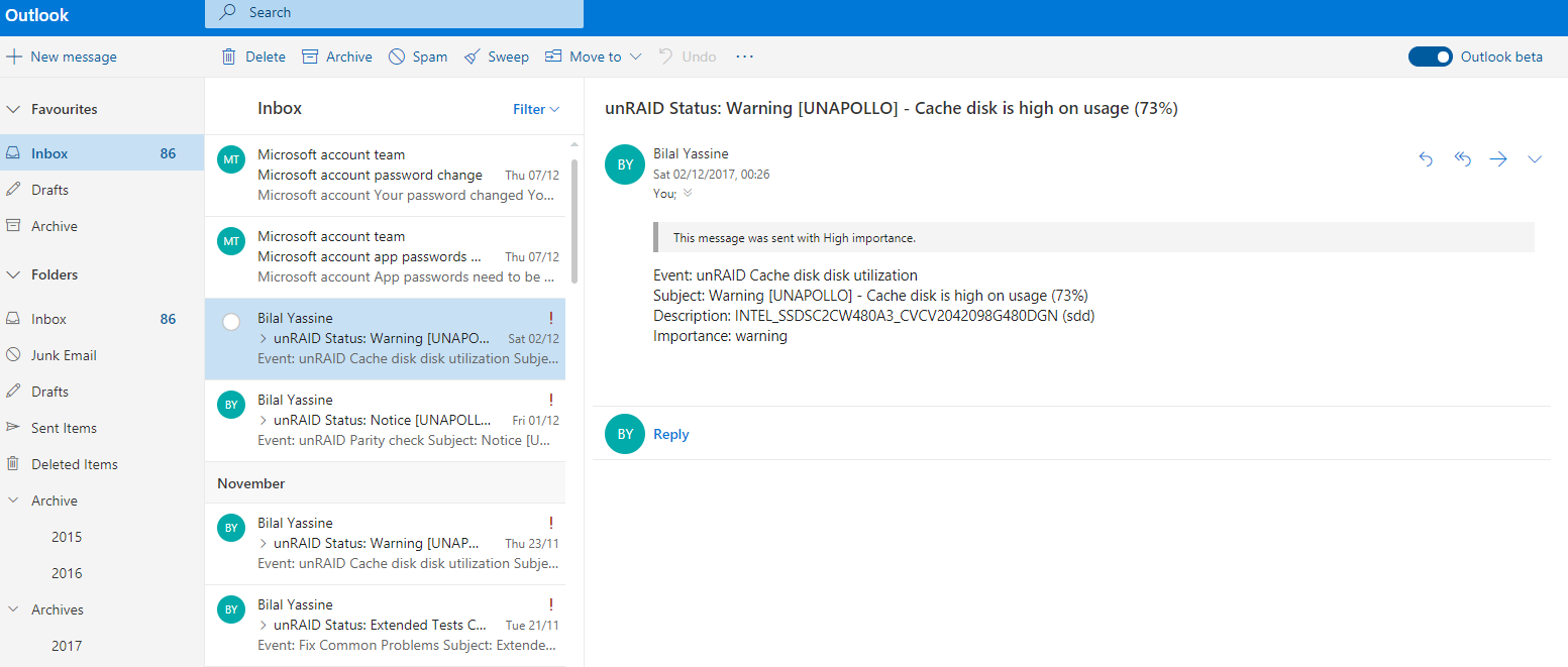

I had setup email status alerts and Pushbullet alerts although i can't see anything in them to say how the disks were organised

But back to the current issue. You said you had status mails enabled. The normal status mail sent out every night contains a list of the individual disks, where it says 'Parity', 'Disk 1', 'Disk 2' etc and for every disk the mail also mentions the serial number of the drive, the drive temperature and if the drive is active or standby.
this is what i meant by status email. and this is the most recent one. they are all like this or telling me a parity check has started or if errors were found by the fix common problems plugin.
Sounds like you never checked the "Array status" checkbox, or possibly didn't enable "Notice"-level mails. So you have never received any array health report mails.
But just to make sure - search your mails for any mails with a subject line containing "array health report".
no nothing I've checked every email account I have just in case.

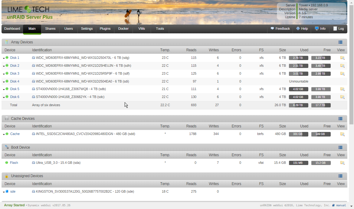

Yep. Do a fresh install and add your license file, then boot, log into the web gui, and assign all your 6TB drives as data drives 1,2,3,4. As long as you don't put anything in the parity slots, you'll be fine. Start the array, and hopefully only 1 of the 4 will be unmountable. If that's the case, stop the array, do a new config in tools, and assign the single unmountable drive as parity, and the rest of the drives anywhere you want, obviously putting the correct drive in the cache slot as well. Select the option to tell unraid that parity is already valid and start the array. If anything pops up as unformatted, DON'T format it, download diagnostics and post back here attaching the diagnostic zip file.
If more than one of your data drives shows as unformatted, don't panic, there have been a fair amount of instances where you need to manually set the drive format type to specify the existing format rather than relying on the auto detection setting.
One step at a time, don't hesitate to pause, step back, formulate a question and post. NO QUESTION IS STUPID when it comes to keeping years of data safe. Better ask than assume.
Ok, I did this and only one unmountable drive. So that one is the parity drive.

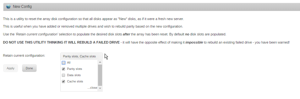

  5. go to tools > new config > and tick the boxes like in the second screenshot. then apply and done
  6. start the array? (hopefully not lose any data?)
You can also tick the data slots or you'll have to reassign all disks, but either way works, just make sure you assign the parity disk, current disk4, to the parity slot.

Before starting the array check the "parity is already valid" box next to the start button, then you should do a parity check, a few sync errors are normal after doing what you just did.
