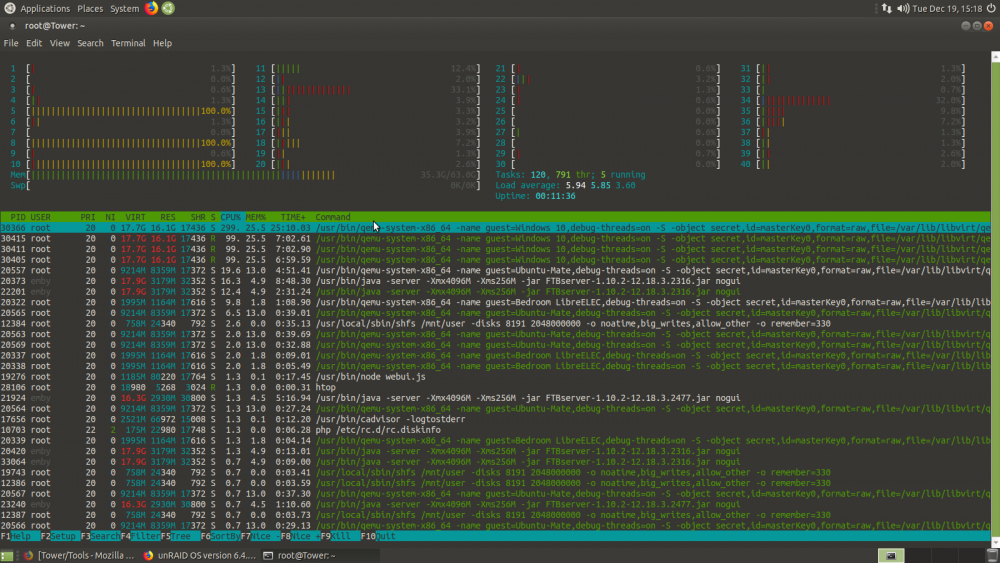

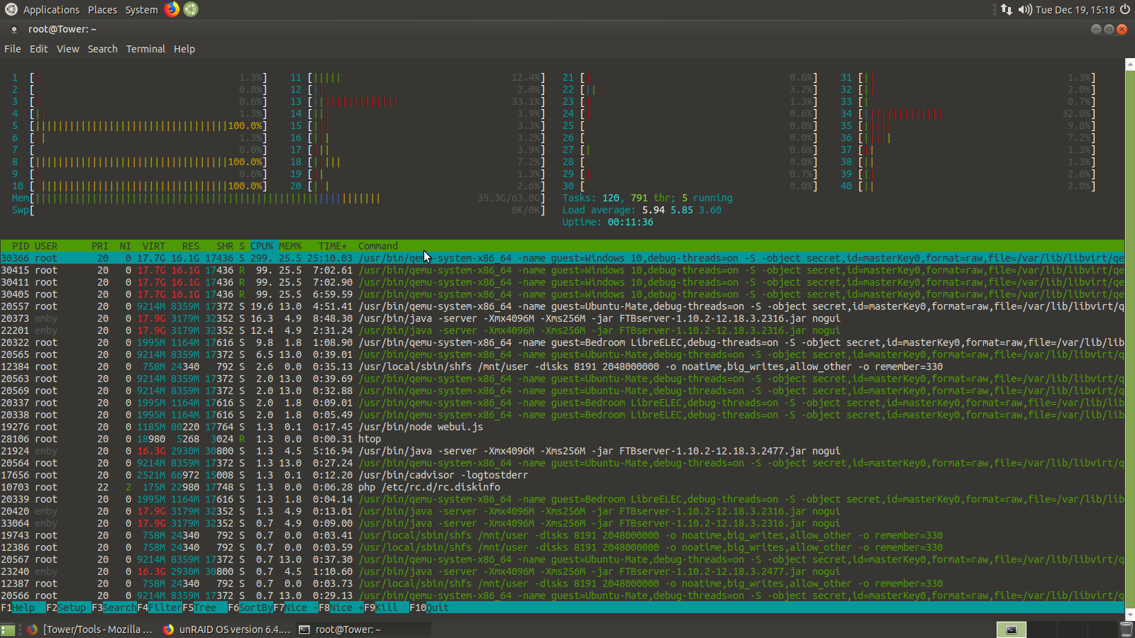

    Just upgraded and no dice, still having issues with windows 10 machine hanging on shutdown. I'm also noticing its taking a lot of CPU power for a hung VM
    5a398277a8048_Screenshotat2017-12-1915-18-36.thumb.png.801cda3ab687996b5cc8194436368837.png
    root@Tower:~# ethtool -k eth0
    Features for eth0:
    Cannot get device udp-fragmentation-offload settings: Operation not supported
    tower-diagnostics-20171219-1513.zip
    Edited by Korny

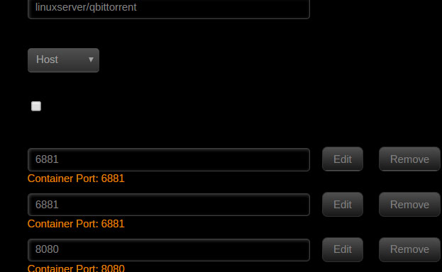

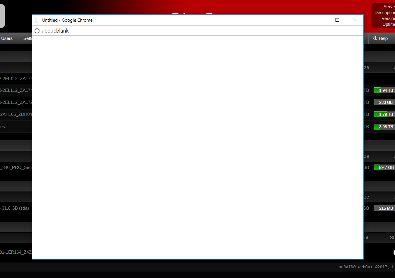

    11 hours ago, PSYCHOPATHiO said:
    Nevermind, a quick reboot fixed it
    I did another reboot again to change a gpu and when I went back online I found that one of my dockers wont start again.
    This docker was on a different IP on the same subnet but now I cant start it cause there is no adapter attached to it, if I try starting it I will get a message "Execution Error, No such container"
    Anyway it will probably fix it self again after a reinstall or a reboot. but this might be an issue in the future.
    I tried the log but its a blank page trying to load, I will reboot and see what happens.
    Sounds like you have some corruption in the docker image. Can you do a scrub on the docker image (see docker settings)?
    This is a screenshot of my logs
    scrub result: total bytes scrubbed: 3.51GiB with 0 errors
    I did reboot twice after and resaults are:
    No more logs they wont load
    Dockers can't be set on seperate IPs
    Edited by PSYCHOPATHiO
    I'm a bit confused here.
    I rolled back to RC16b and still there are no logs but I can set the dockers to br0, so I reinstalled the old video card as this is the only thing I changed but all the same.
    I upgraded back to rc17b and there are no logs, and when I set "qBittorrent" docker to br0 it disappears from the dockers! I reinstall in 1 second and it says successful. I did this multiple times.
    When set to Bridge the dockers are good.
    Just did a reboot to check something in the bios, came back to dockers and no longer can set to br0
    I'm using unRAID DVB edition
    EDIT: I rolled back to RC14 same issues then I think my files are somehow corrupted from the update!
    How's everyone getting on with W10 VMs with 17b?  I rolled back to RC14 because I was having problems with RC15 and the reported problems with RC16
