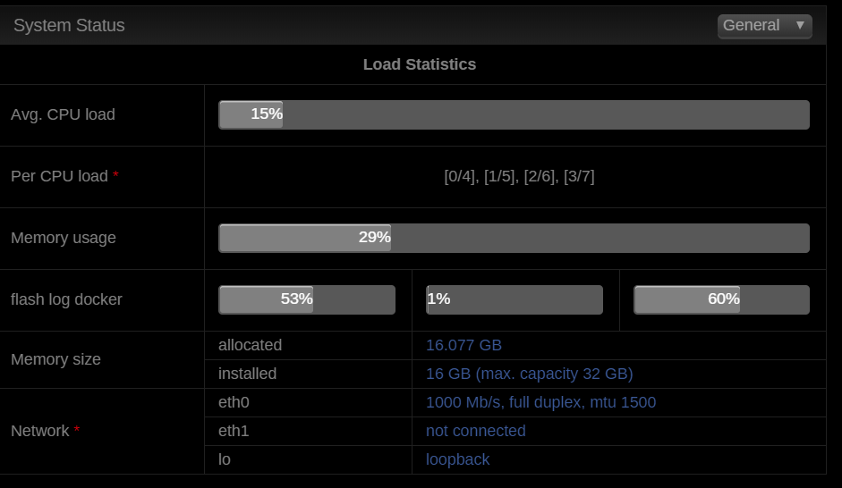

Nothing major, but individual CPU activity not displaying in Chrome.  No errors in the console...
Click on "Per CPU load" to toggle between full and summary view.
D'OH!  Thanks

I was having trouble with the latest RC17b so I decided to reinstall a fresh copy on the same usb and reformat the cache drive (appdata and system) yet I'm still having some same issue.
under tools the log works perfectly but the log tab isnt working correctly as it takes forever to load.
I'm not sure if others have the same problem
EDIT: after timing it, it takes exactly 60 seconds to load.
