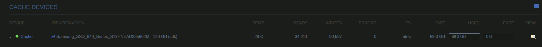

I'm about ready to throw this box out the window...With that being said, here we go:
I recently started moving all of my docker data and images to the cache drive. The data in this share existed on all disks in the RAID which was horrible for performance (Share Name: /mnt/user/cache_only). So I made the share cache only and began moving data from Disk1, Disk 2, Disk 3... to /mnt/cache/cache_only. I was successful in moving most of the appdata except for Plex. About halfway thru the transfer it said that my target had no space left, even though there was 60G worth of free space available. I aborted the process, moved some files back to other disks and started the process again. I checked the unraid console and it's showing some really odd values for the cache disk. First off this is a 120G SSD, but when this ugly bug peaks it's head out it will just slap whatever size it wants for "Disk Size" in this example it's showing 69 with 0B free. This is causing some serious issues with the dockers, cache data and I'm worried at some point (this has happend 4 times just today) that my docker data is going to get corrupt. What's even more odd is I stopped trying to transfer the remaining plex files over because of this error. However, now UnRAID is just wigging out on its own with no intervention. Screenshots and syslog attached.

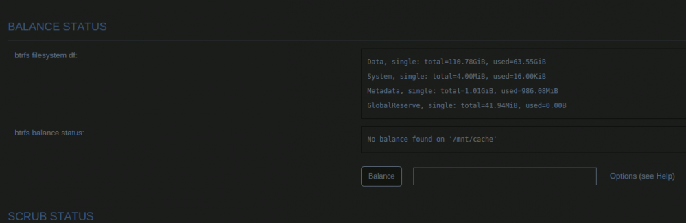

btrfs first allocates chunks, mostly data or metadata before it can write to them, although you have lots of data chunks with free space your metadata is very close to being full:
so btrfs tries to create a new chunk for metadata, it can't, hence the ENOSPC error.

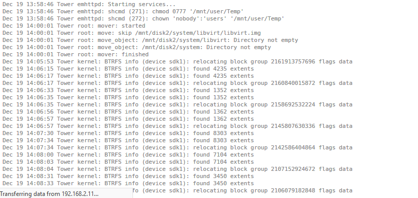

w00t! I am now balancing with 75 and the GUI is back to normal. I'll let you guys know how it goes thanks @johnnie.black and @limetech

Balance Complete. I'll start moving data back and see if the issue pops up again. Thanks for all the help!
