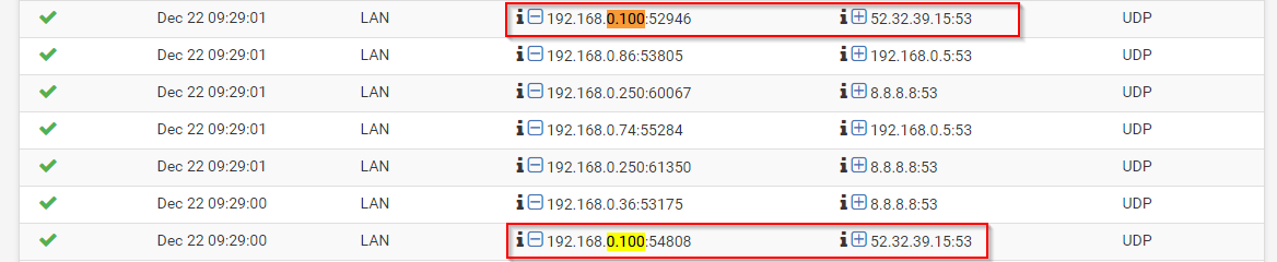

Hi guys, I have my unraid configured to use google for DNS but for some reason it instead keeps using DNS as it would be provided via DHCP? I have stopped the array and set it then started the array again, it stays the same, even a reboot did nothing. I have set it both through the GUI and manually in network.cfg file. I wasn't sure what DHCP_KEEPRESOLV meant exactly but have tried this as yes and no. I know the DNS is not working as it should because I can see in the firewall logs the DNS traffic from my unRAID using the wrong DNS server as you can see in the image below, the 52.32.39.15 address is the DNS server that would be provided via DHCP but that isn't enabled. Unraid version 6.3.5

Hi, result is 52.32.39.15 which should be 8.8.8.8 and 8.8.4.4 as set in the settings.
I did a 'nano /etc/resolv.conf' and updated the file and saved the changes. I presume this will work for now, not sure if it will stick after a reboot or not but there must be a bug around the GUI settings not being applied correctly.
