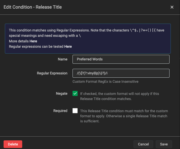

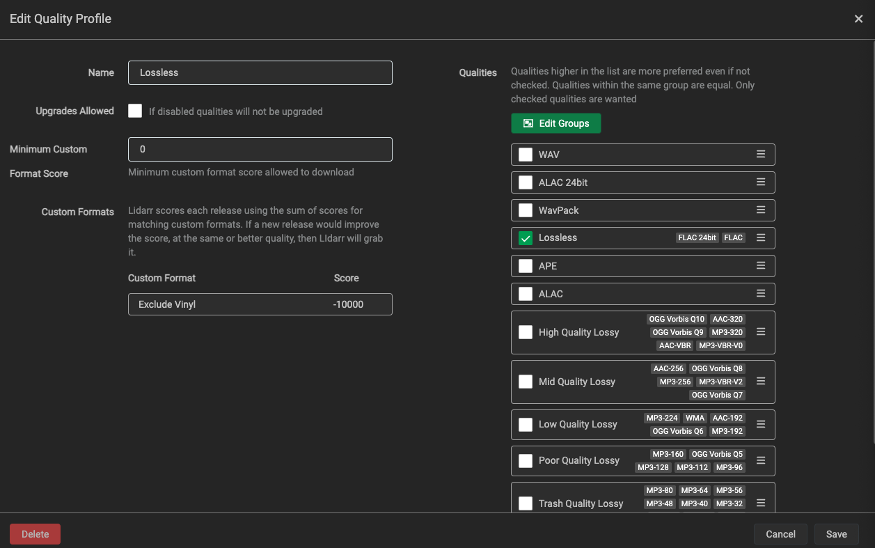

New to Lidarr and been trying but struggling to find the information
I think i created a tag to exclude vinyl. However i also see the setting to score exclude vinyl, but when i look at my already owned material after changing that score it scores at that number. Is the exclude vinyl number actually mean non-vinyls score this?
My goal is to set lidarr up to only look for flacs both regular and 24 bit but am struggling to accomplish this. I also tried to delete the any profile but it won't let me delete but i can't find anything associated to it
