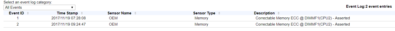

Along the way I have seen an error in the SuperMicro log, jonly occurred this one time:

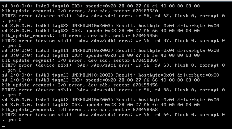

Screenshot with point to hardware issues with your SSD, check cables
Ok I will look into those. For my education why would it only be an issue on vm reboots? VMs run fine otherwise, and all Dockers are on SSD too.

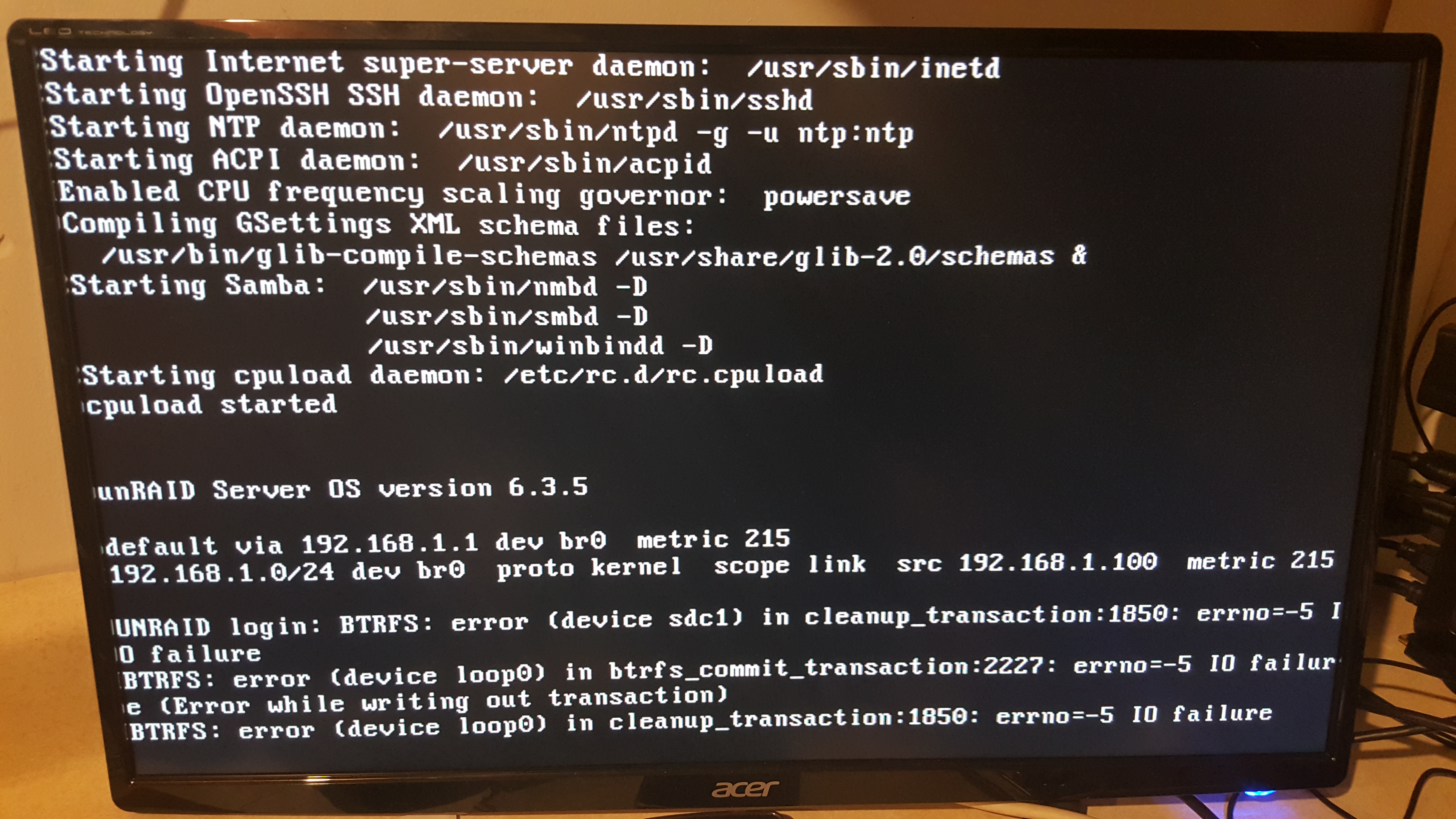

Removed faulty 4tb hard drive and replaced with a larger 8tb one which I had been meaning to add anyway.  Also swapped out SATA cables for the kind with clips. It took a few days to rebuild, then everything seemed stable and the VM was able to reboot successfully several times.  Today I rebooted the VM and got this:
now what?
Those are hardware errors, so bad device, cable, controller or power.
