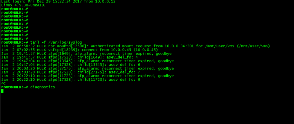

Ok I have tail -f running and will try to copy the logs off if I can. The problem that I am running into is when it gets to this bad state, I cannot execute any commands....hard to explain but here is a snippet of what it looks like when I tried to get a diagnostic when the issue was happening -
root@HULK:~# diagnostics
^C^Cq
^C
^C
Thats all it does, no out put  besides me trying to cancel the command and at this point I was unable to break out of this using ctrl + c and also unable to do a ctrl + alt + del in hopes that it would issue reboot command.

Ok it repro'd again and here is are the last bits of the syslog that I was able to capture using tail -f

FYI when I type "diagnostics" it just does what you see below....at this point I won't be able to cancel out of this

You are getting me wrong again. Let me start over so that we are on the same page, I am experiencing an issue with the product that I purchased. Per your technical advice, you would like me to run a command to generate a diagnostics file and would also like me to produce a copy of the running log file so that it could give you some insight as to what is happening so that you could provide me some support. I am with you so far, hope you are as well.
The problem that I am facing is that I do have a running log file (tail -f /var/logs/syslog on both console session as well as SSH, same result) however it does not provide any good logging to help diagnose the issue. Next request was for me to generate a diagnostics file (something like show tech) so that you could get even more details in hopes of finding some sort of clue, however the problem is that when the system is locked up I cannot log in via new SSH session BUT if I already have a logged in session, I am able to run additional commands such as "ifconfig" and "ping".
So next step for me is to physically connect a monitor and see what happens but again, when the system is in such a state, all I am able to do is enter the command and then the system halts....not sure if that is the correct word but it no longer takes any commands at that point. Here is an example of what that looks like -
As you can see, after I entered "diagnostics", in theory it should do something but in reality it stays like the above. So here we are, what would you like me to try next? I could definitely try a new OS on this hardware BUT are you serious?????????????????????????????????????????????????
