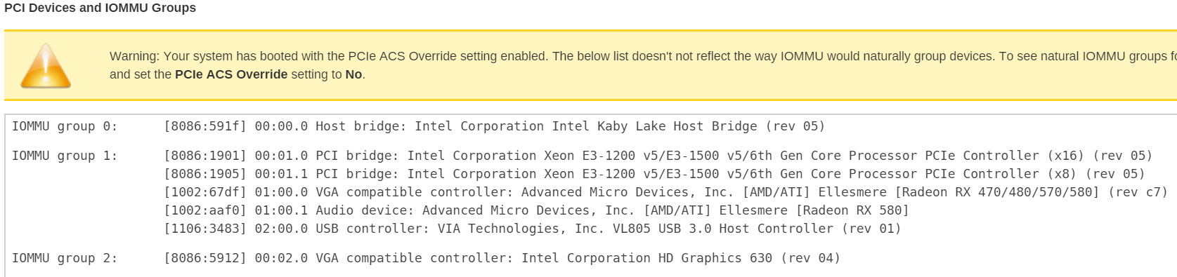

interesting, your gpu isn't alone in it's iommu group. It's together with a pci bridge and usb.
/sys/kernel/iommu_groups/1/devices/0000:00:01.1
/sys/kernel/iommu_groups/1/devices/0000:01:00.1
/sys/kernel/iommu_groups/1/devices/0000:00:01.0
/sys/kernel/iommu_groups/1/devices/0000:02:00.0
/sys/kernel/iommu_groups/1/devices/0000:01:00.0
00:01.1 PCI bridge [0604]: Intel Corporation Xeon E3-1200 v5/E3-1500 v5/6th Gen Core Processor PCIe Controller (x8) [8086:1905] (rev 05)
	Kernel driver in use: pcieport
00:01.0 PCI bridge [0604]: Intel Corporation Xeon E3-1200 v5/E3-1500 v5/6th Gen Core Processor PCIe Controller (x16) [8086:1901] (rev 05)
01:00.0 VGA compatible controller [0300]: Advanced Micro Devices, Inc. [AMD/ATI] Ellesmere [Radeon RX 470/480/570/580] [1002:67df] (rev c7)
	Subsystem: PC Partner Limited / Sapphire Technology Radeon RX 470/480 [174b:e347]
01:00.1 Audio device [0403]: Advanced Micro Devices, Inc. [AMD/ATI] Ellesmere [Radeon RX 580] [1002:aaf0]
	Subsystem: PC Partner Limited / Sapphire Technology Device [174b:aaf0]
02:00.0 USB controller [0c03]: VIA Technologies, Inc. VL805 USB 3.0 Host Controller [1106:3483] (rev 01)
	Subsystem: VIA Technologies, Inc. VL805 USB 3.0 Host Controller [1106:3483]
	Kernel driver in use: vfio-pci
Let's try a few things.
first, can you move your gpu to a different slot and retry? you may need to reassign the gpu.
If it does the same error, please note the iommu groups (system>system devices>iommu groups) then try the following:
Modify your syslinux.cfg between append. initrd=/bzroot to this and reboot:
append pcie_acs_override=1002:67df,1002:aaf0 initrd=/bzroot
look and see then if the radeon and it's sound component are in their own iommu group now and try to restart. Note if the error is same/different afterwards. the pci bridges in the group may be causing the issue here.

Using the ACS override line did not change the IOMMU groups -- both AMD devices (GPU/audio) are still showing in group one along with the PCI bridges and my PCIE USB3 card:
The second linked thread sounds just like my problem:
So just like the linked thread, I am using a PCIE USB3 card in order to pass-through hot-swappable USB ports to Windows 10. What's weird is that my hardware configuration hasn't changed in that regard, I've had that PCIE USB3 card for long before this problem came up.... also that thread doesn't have a real solution to the issue. I don't have 3 monitors to connect to solve it. I am also using the Display Port output, not HDMI.
One thing I did notice that was kind of weird was the CPU in my IOMMU Group 1 is showing as Intel Corporation Xeon E3-1200 v5/E3-1500 v5/6th Gen Core Processor PCIe Controller (x8) [8086:1905] (rev 05). My CPU is an i7-7700k, not a Xenon. Is there maybe some conflict there with the C236 chipset on the motherboard?
Edited by scud133b

use pcie_acs_override=downstream,multifunction
So using this command did separate out the AMD components into their own IOMMU groups. The GPU is on IOMMU 12 and the audio is on IOMMU 13 now (and the USB3 controller is on group 14).
But I'm still getting the IRQ errors and of course can't successfully reboot the VM.
