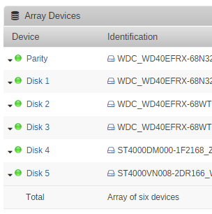

So now I've done it and changed one of the parity drives to a data one.  I decided to keep "Parity 2" as a parity disc, but even though it's the only Parity disc now it's still named "Parity 2".
Is this just cosmetic or can it cause problems later on? (I'm pretty sure it's cosmetic only but I just wanna be sure...)
If it's cosmetic, is it possible to fix easily?
(Disk 5 is clearing)

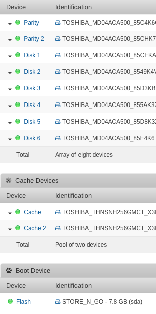

I'm gonna sleep better now. OCD made me do it.
Very pretty... but how can you stand not having all the same make and model of disk in your array? :P
Damn! I need a Toshiba flash!
Your serial numbers are out of order.
That would only really be worth fixing if they happened to be consecutive!
