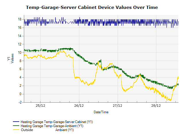

Here are the temps inside the rack, in the garage, and outside over the last few days. Blue is the temp within the cab. I think that sensor only has a resolution of 0.5Deg C. Green is the temp in the garage, Yellow is the outside temp.
Temps are in Celsius.

I have got to say I am incredibly surprised at how constant the temperature in the rack stays despite the garage temperature! I suppose that comes from cutting the rack fans below a set temperature.
