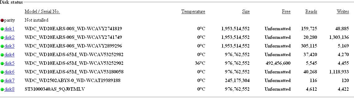

I was copying files to a few of the disk shares when I woke up to find this (attached image).  After reading this post, I closed all files and rebooted both PCs that were transferring data to the share.  I stopped and restarted the array several times.  I've disconnected the PC mapped drive to the \\tower\share.  I've ran > lsof /mnt/disk5 and nothing is returned.  Is it safe to stop the array and just reboot?  I would appreciate your insight.
Disk5 has a process running on it, or, a process using it as its current directory. (make sure it was not you cd'd to disk5, so log off or cd "/")
Or, perhaps the process that was present is no longer there.  Press "Stop" once more.
Since you have no parity drive installed, you do not have to worry about re-calculating parity on a forced shutdown.  So if you need, just power down.
Joe L.
Once again Joe, I appreciated the quick response on this Holiday morning.  I restarted the server and everything is back.  Thankx
