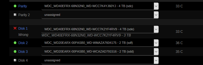

So now I have a whole new problem.  The data rebuild on my new drive just completed so I stopped the array so I could power down the system and replace the next drive since I'm replacing them all.  Except when I powered down the array the UI now shows the array wants to see the old data drive instead of the new one which just got rebuilt and appears as if it won't let me start the array without kicking off another rebuild.
screenshot-192_168_88.10-2017-12-29-18-32-33.png.b0c5aef4b238de0766f3fc3815379ab9.png
polaris-diagnostics-20171229-1832.zip
Edit:
Glorious, just glorious.  I figured I should be able to just restart the array and do the data rebuild.  After all, the data rebuild completed successfully according to the UI and syslog, therefore it should be able to quickly validate that the data is there and not need to copy it all over again.  No, no check at all, it's redoing the whole  write all over again.  At least when I was doing the parity swap you could say I executed the procedure from the manual incorrectly because I didn't complete the data rebuild on the old parity drive which is in the process.  Here I followed everything step by step with no errors anywhere and I'm still having to repeat the process and hope it just works the second time.  See you another 8 hours.

That's not normal at all, you may have a problem with your flash-drive, but we'd need to see the syslog before rebooting to see what happened.
The diagnostics I included with the screenshot was taken after the write finished and I stopped the array, no rebooting.  After that I started the array and let it run, and here is the diagnostics from after I got back to the server and the second data rebuild was complete.  After this report (polaris-diagnostics-20171230-0719) I stopped the array and now the UI is telling me everything is normal, no unexpected disk.  If it's the USB then great, finally something I can pinpoint, but this time I did absolutely nothing different and haven't rebooted since before the first rebuild and somehow it's just working after the second rebuild.
polaris-diagnostics-20171230-0719.zip
Yes sorry about that, must have seen those before my coffee, something weird going on here, not really sure why as I never seen this before, right after boot disk1 is seen as not assigned instead of empty:
