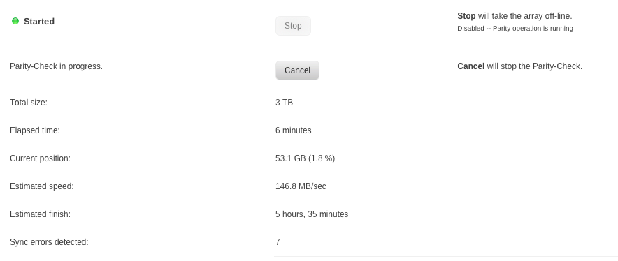

Ok, new power supply is in, parity check started, and so far so good.. its been running a few minutes and hasn't disabled the disk yet.
I'll let it do this pass without corrections (I unticked 'write corrections to disk') and if it succeeds, ill run a check again, with it ticked.
