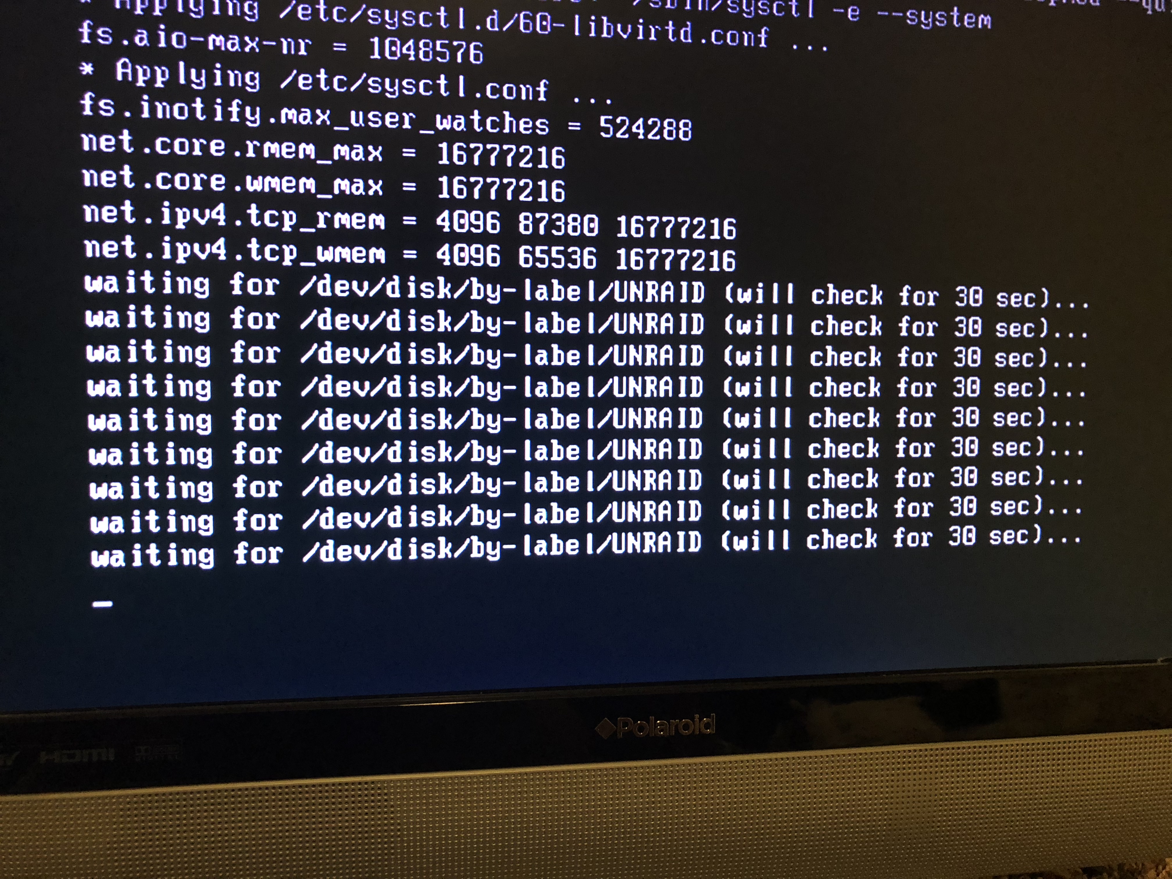

I came from freenas to try implement this system instead. At least to give it a shot. I’m running into issues setting up everything. Specifically my server is booting the flash drive, but not actually mounting the /boot share portion of it. I used the unraid usb creator but am still not able to get it to mount. Hopefully someone has more ideas than I do? Any advice? I’m using a ta790gx MoBo with an amd processor if it makes any difference.

That's usually an issue with the flashdrive, try using a different port, USB 2.0 preferred, or a different flashdrive.
