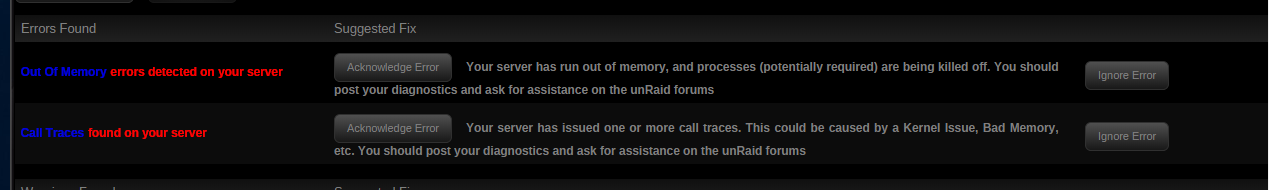

So the last few days i have been getting out of Memory Errors and Call Traces found on my unraid Server. i am thinking it might have to do with Plex Docker but not positive on that. Attached is the system Diagnostics and a screen shot of the errors i am seeing. has any one seen this issue and if so how would you fix it?   i could see being out of memory if i only had a gig or two but i am running 32gigs with 8 Split out for a windows VM right now and the rest is available the rest of the system.  Let me know what you guys think and thank you for all your help.

This usually helps:
https://forums.lime-technology.com/topic/55910-out-of-memory-errors-detected-on-your-server-call-traces-found-on-your-server/?do=findComment&comment=546982
