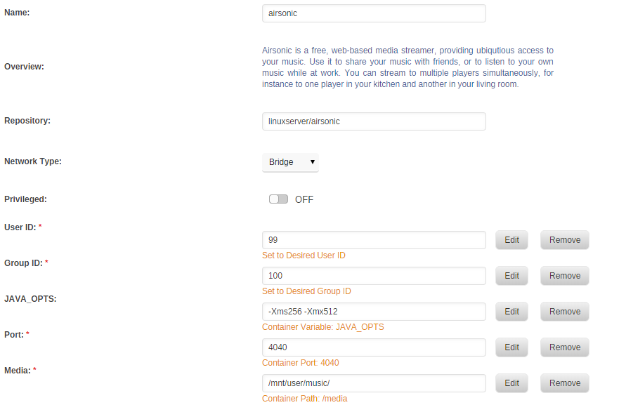

Hey guys,
Airsonic isn't working (for me) since the recent update. Got this error (repeating into infinity) today:
Too small initial heap
Error occurred during initialization of VM
Restarted the container, no joy. Forced an update, no joy.
What else can I provide you to help diagnose?

Okay, after removing the new JAVA_OPTS optional field the container was able to start, and I'm back up and running. I have to assume it's somewhat important to keep it in, but for now it doesn't seem to do any harm to delete it.

JAVA_OPTS is not new in the template, but it wasn't working before. So I fixed it and broke the template as there should be an m after the numbers.
Ah okay. Well, changing that up to -Xms256m -Xmx512m worked. Thanks!

If you read further up the page, the solution is mentioned by both me and @ridge
I had the same heap too small problem and adding an m onto the end of the params fixed it for me.
